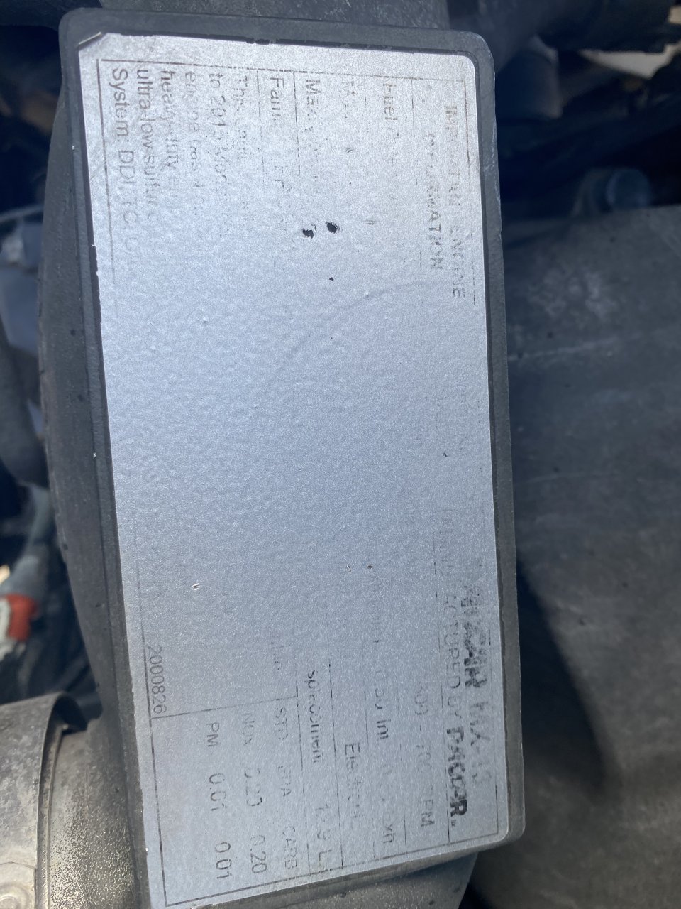

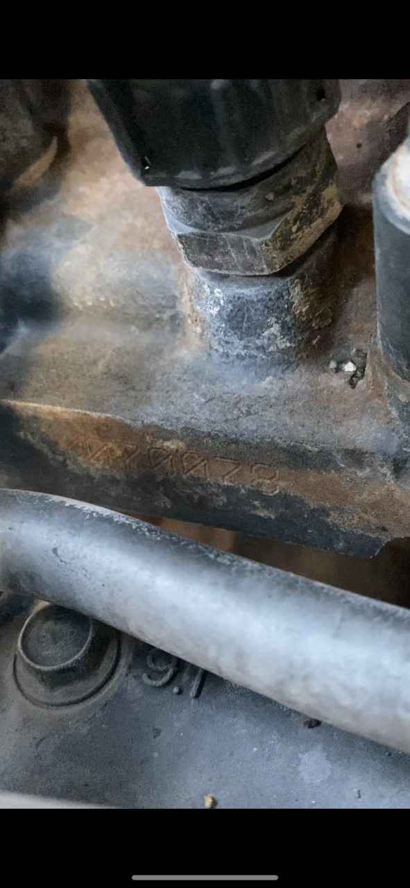

    I’m trying to figure out which EPA is my Paccar MX13 in order to get the correct service Manuel for it. Engine number is partially erased & the one on the block says it’s
    Y270078
    Can someone help me out? Thanks in advance.

    model year 07-09 is epa 07. 10-13 is epa 10. 13-17 epa 13 17-up epa 17. Have to be be careful with model year change over. Ex: build date of 11/12 might be epa 13.

    Double check your number does not come up as a good number.
    Perhaps Y027078?
    Thats an EPA 13. .....EPA label says 2015 model year.

    Looks like a Y070078 and you have a EPA 13. No question.

    Hi, would that be date of engine or truck ?
    My engine mfg 2016 , no build month shown. Truck is titled 2017.
    Engine Y100942

    1/20/16
    MX13-EPA13
