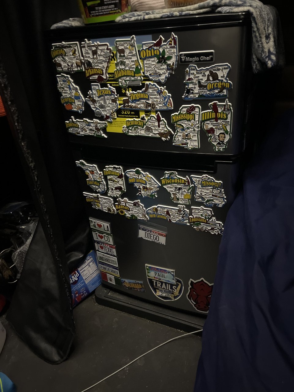

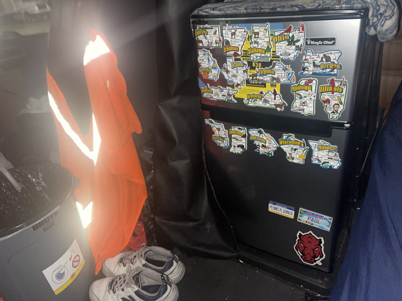

    71298665352__22799E0E-CFA3-4DA0-BB81-7DB7B27BCE88.jpeg 66864448362__F3A57631-6C48-43A3-A6E6-EC516DEA3168.jpeg
    Here’s refrigerator now!
