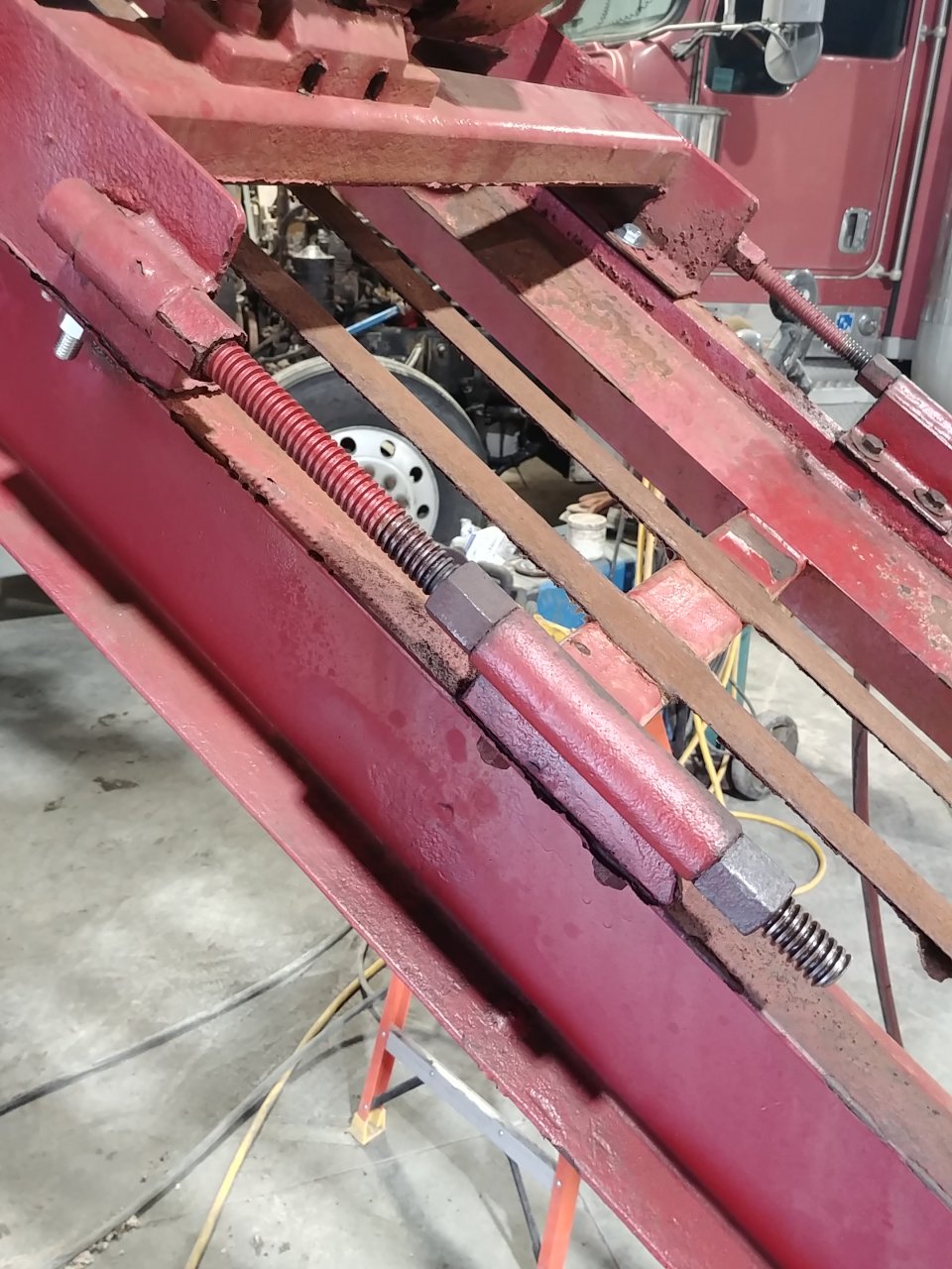

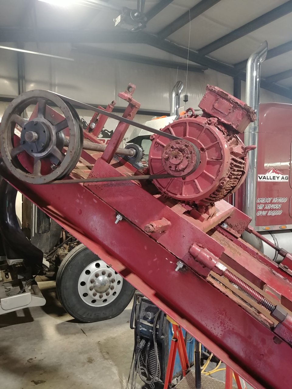

    @JolliRoger this is my favorite part of the whole machine. 100% my own design. Its the mechanism used to tension the drive belts on the motor.

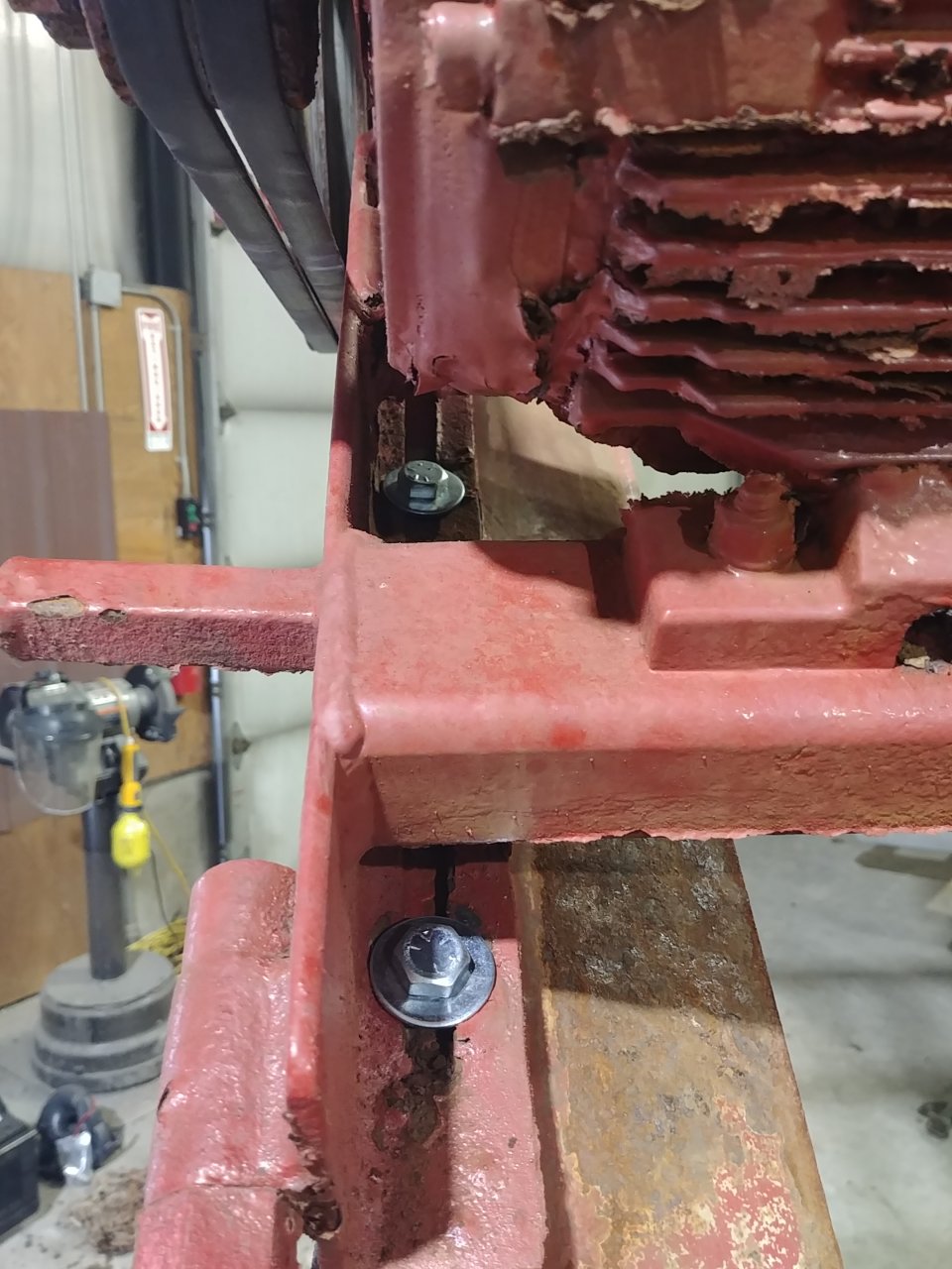

    Those long threaded shafts move the entire platform the the motor is mounted on up and down the main frame to tension the drive belts, the 2 bolts on each side ride in slots in the platform to keep it straight and in alignment with the frame.
    That is a stainless steel shaft with ACME threads, with mild steel ACME thread nuts on either side of a length of heavy wall mild steel pipe. By using a mild steel nut on a stainless thread it won't rust the nuts to the thread and the nuts and thread wont gall to each other. Same principle applys to the stainless thread through the mild steel pipe. Also the threads themselves are beefy enough that even with a bunch of crap jammed into them they are nearly impossible to strip out at the speed of a wrench.
    This machine hadn't had those nuts moved for at least 2 or three years... And even though I had to torch off all the regular bolts, thise freed up with only a wrench (no heat needed) and with a little lubricant I had all 4 of them spinning by hand in less than 5 mins.

    Concept is nor unique to my thinking, but the app of acme thread's is, I suppose that in my experience, long acme threaded rods were not topically on display at the bolt house.
