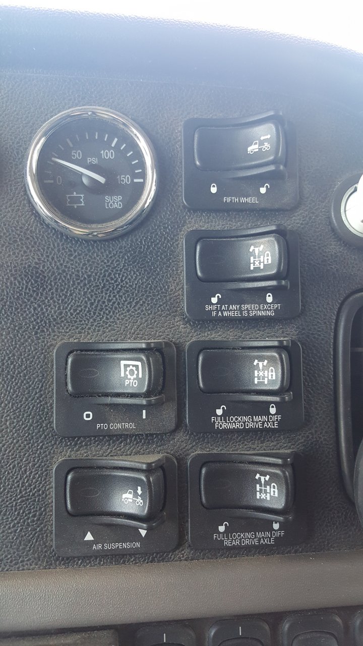

    No locker = no sale in my mind. When I singled out my W9 I looked specifically for an axle with a locker. Not gonna chance getting stuck on a speed bump lol.

    right, thank you. I was just high centered the other day in a driveway and I had to lock out. Good info here. Thanks again

    Most highway spec trucks only have an interaxle lock. That only locks the two drive axles together so instead of only 1 out 4 wheels spinning out in a low traction situation, 2 out 4 (1 on each axle) will spin out. Diff locks lock the drive axle solid. On a truck with full lockers, all 4 corners are locked together when everything is engaged.

    Inter-axle: at any speed so long as you're not spinning (throttle on or throttle off), any road surface
    Differential: at or below the engagement speed (on newer trucks there's usually an engagement speed which is lower than the disengagement speed, both of which are controlled by the ECM, i.e., 25 kmm/h / 45 km/h... on my trucks I had the engagement speed and sometimes the disengagement speed increased), so long as you're not spinning or turning, should be very loose/slippery road surface​

    Its really no different than floating gears in a transmission. Your diff lock just locks an axle shaft to the carrier. As long as there's no speed variance between the left and right sides you should be fine.
