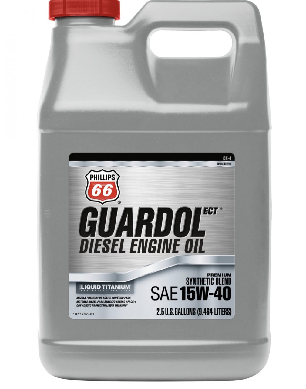

  8. Diesel Dave
    7,313
    14,677
    Jan 20, 2010
    Hesperia, Ca.
    When I had a little blow by, I switched to Guardol ECT, and the blow by stop on my former Cat. I now use a similar oil from a local distributor with similar additives and some. E414BFBB-0480-4C06-B21D-3CFBA2D27883.jpeg
