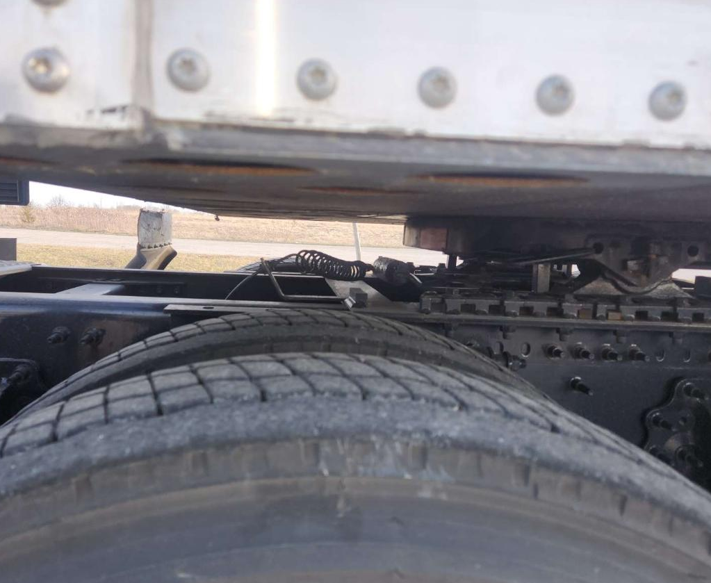

    I have no scale nearby and was wondering if making the distance between the top of the tire and the bottom of the trailer equal on all your axles would be a safe way to set your trailer tandems at. Or is one end of the trailer normally higher than the other? I know my total weight is about 77k pounds.

    As long as both tractor and trailer are air ride and the air ride system is operating as it should, the distance between you tractor and trailer tires, and the trailer should be the same loaded or empty.

    Sometimes have the back trailer axel...directly under where..end of the freight in trailer is..will mostly make your trailer legal

    Huh, I never thought about that, and it's a good question, but Kemosabi is right, a properly functioning air ride will keep the same height regardless of weight. Maybe on a spring ride, bottom of trailer to ground. an air ride trailer gauge you could get it almost dead nuts. If questionable axle weights are a common thing, only a fool would chance it with no scale around. I hauled rail cans out of Chicago, no scales around, I had a drive air gauge that saved my aXX so many times. It was easy to plumb in, and if you are paying the fines, it will pay for itself. Any boss will agree, maybe even get an attaboy(or girl). 62 pounds on the gauge was 34,000, and pretty darn close, as 63 was questionable. Figure 77K, 11,000 on the steer, gauge says 62 pounds, so 45 on the tractor, what, 32 on the trailer, you can breeze through them scales,,:salute:

    You need to measure the distances at all positions & record GVW & axle weight enough times AND then scale the total & axle weights to verify if this idea works or not. I suspect the idea will not get you closer than 5,000 lbs of actual weight confirmed by a scale. That's just a guess..I see a desperate driver's measuring accuracy adjusting based on desperation like overestimating possible range of a near empty fuel tank when you are late for something very important.
    Don't forget trailers are from numerous makers & condition & tires are of various tread height. It's an interesting idea.

    Putting the rear axle directly under the end of the freight is usually what i do, but in this case the freight was all the way to the door. I ended up at hole 19 which seemed good enough as I was not called in at the scales.
