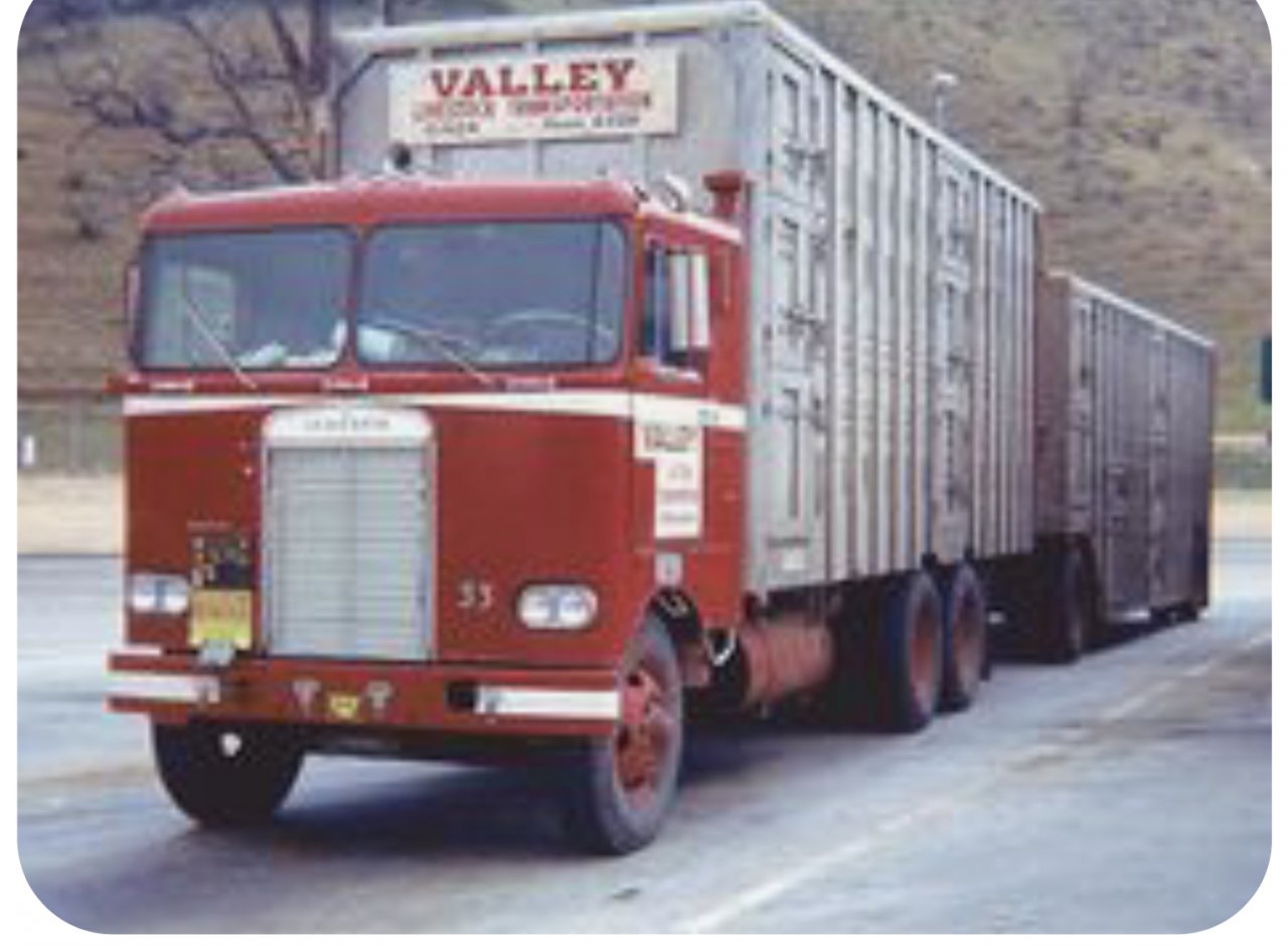

  3. SmallPackage
    5,669
    18,117
    Dec 20, 2019
    Marion Texas
    truck and full trailer combo. Out west this setup ruled for decades because more could be hauled in the length allowed.
    wis bang, brian991219 and Val_Caldera Thank this.
