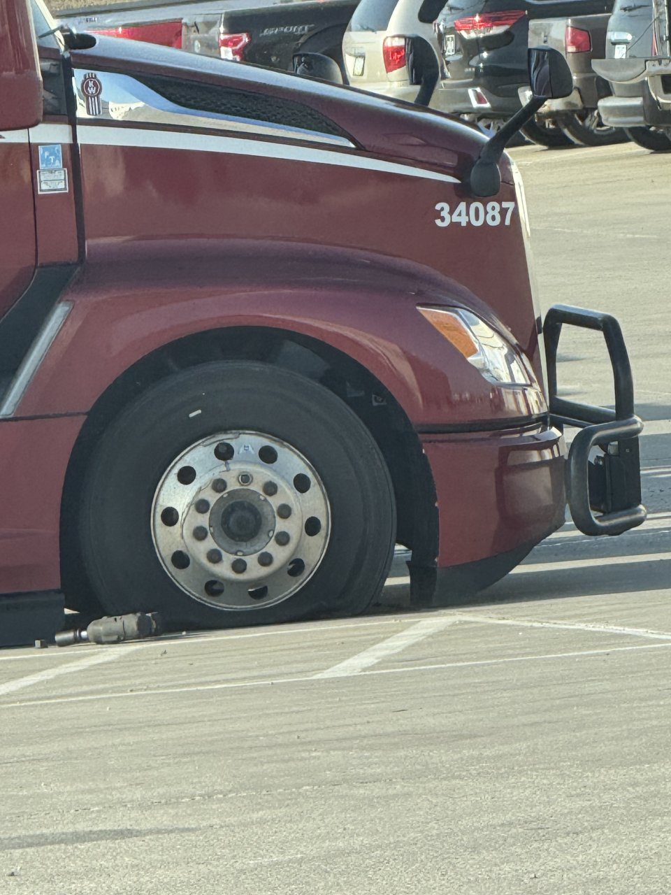

    Here’s one example lol. No, their tire wasn’t flat when I got to the terminal last night around midnight, but it’s probably why he’s here. Imagine being out on the road and not noticing your steer is down to 70psi on a post trip, and then waking up with it off the bead on a pre trip. A simple 2 hour fix just doubled in price and cost you part of your day
