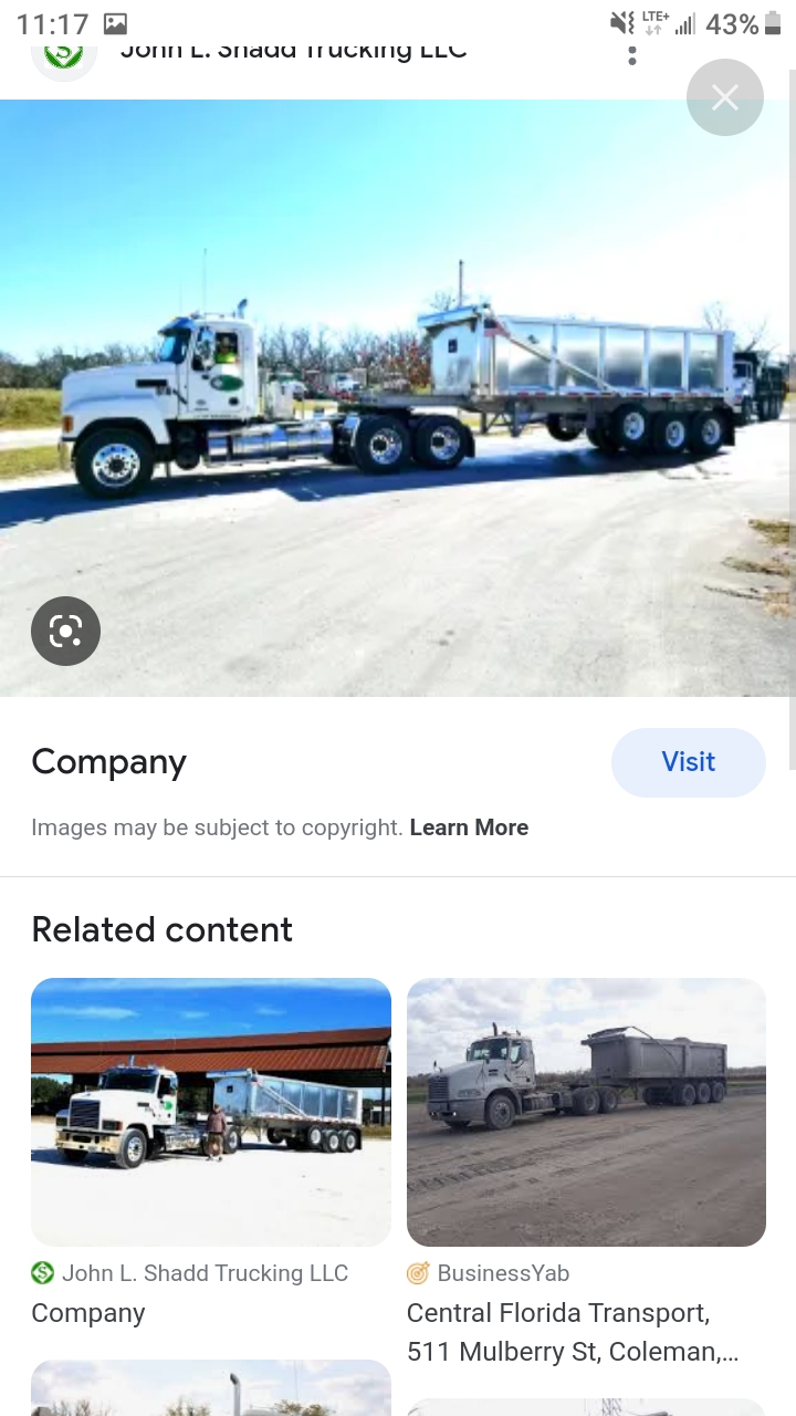

    Question for you, what’s the deal with those long wheelbase single axle trucks pulling the tri-axle end dumps? What is the reasoning behind those? I tried asking a guy once but he no speaka and I no speaka his language either.

    Can't find a picture pulled by a single scew tractor, but yes they are crawling all over this place!!
    So I'm just as curious as you are, maybe more so as I previously ran a single screw FLD, but have been stymied by the same language barrier.! Lmao :D They run channel 9 & 13, but yet to come across a bilingual one. Lol Thought I might get some local work in the winter & stay out of the snow, but still hasn't panned out..
    All I know is they're called FL spec end dumps.
    22' box with 8' of extra frame rail as a tandem, or
    24' box with 8' of extra frame rail tandem & a single tire pusher
    See both pulled by singles screws, or tandem tractors.
    One time I spanglished with a guy while fueling. He was 6 axle, and said 78,500 legal gross weight on 6. Gotta be less for the single screw rig on 5.?
    So it doesn't seem they get the same dump truck permit? Tandem dump with a pusher & 20k steer (so short 4 axle) is allowed 70k gross here..
    They haul mostly sand, & phosphate. That's about all I got for ya. Lot of words, for little info.. :oops: I will find out more before I'm in the grave! Lol
