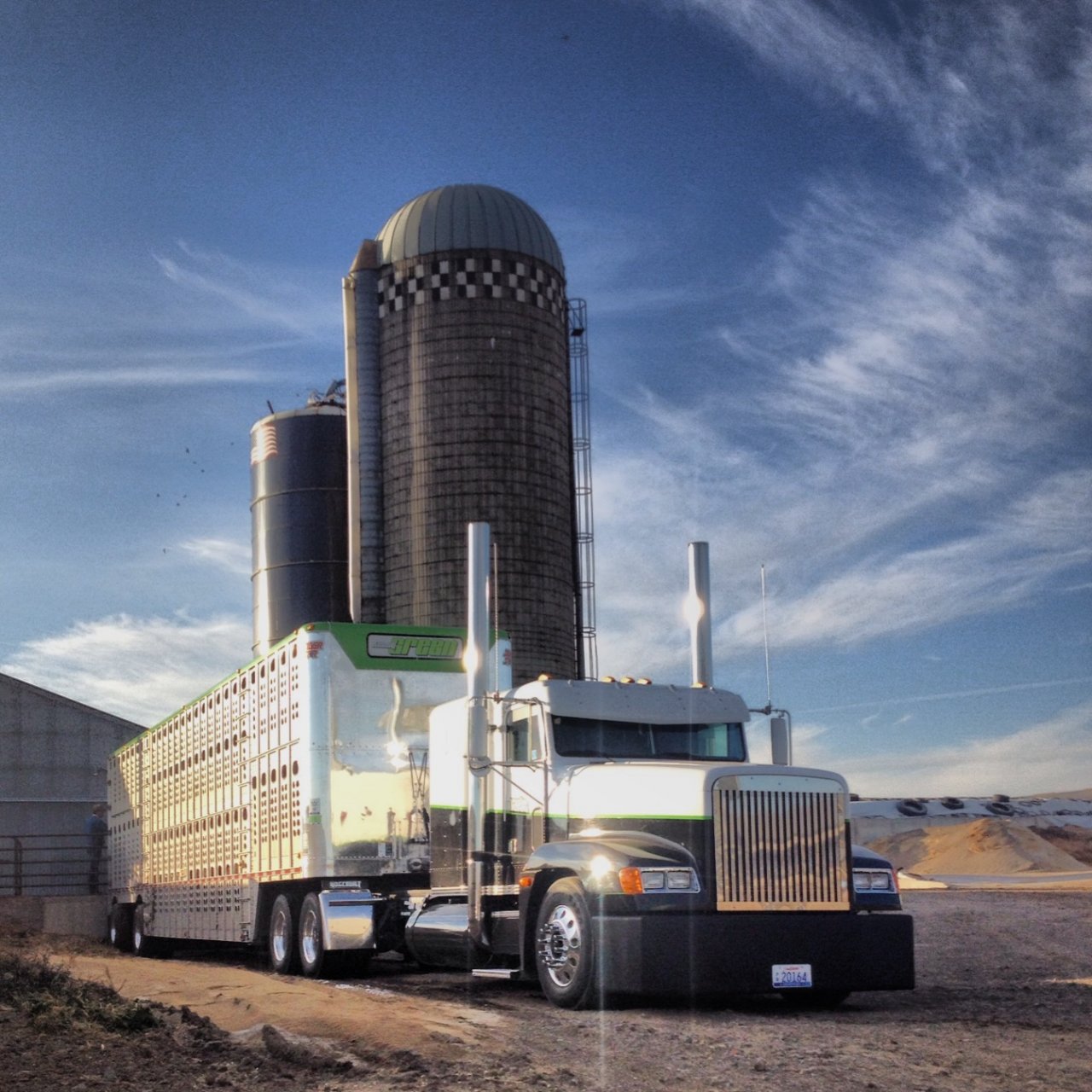

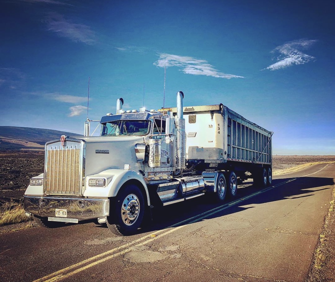

    Okay, I have just read thru all of this and need to do so again, but I have learned things I didn't know I didn't know so thanks for that everyone but I think from the pictures posted we have all missed the biggest question of all.... has @Long FLD ever driven a truck that was not at least partly blue?
  3. Long FLD
    Long FLD Road Train Member
    12,445
    51,596
    Mar 4, 2015
    Yes I have. Lol. My FLD and the truck I drove when I was in Hawaii.
