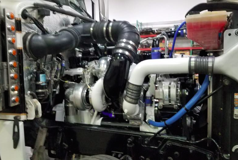

  11. snowman_w900
    4,418
    81,013
    Nov 25, 2010
    What kind of paint did you use on the engine? Did you paint it yourself?
    Oxbow and SAR Thank this.
