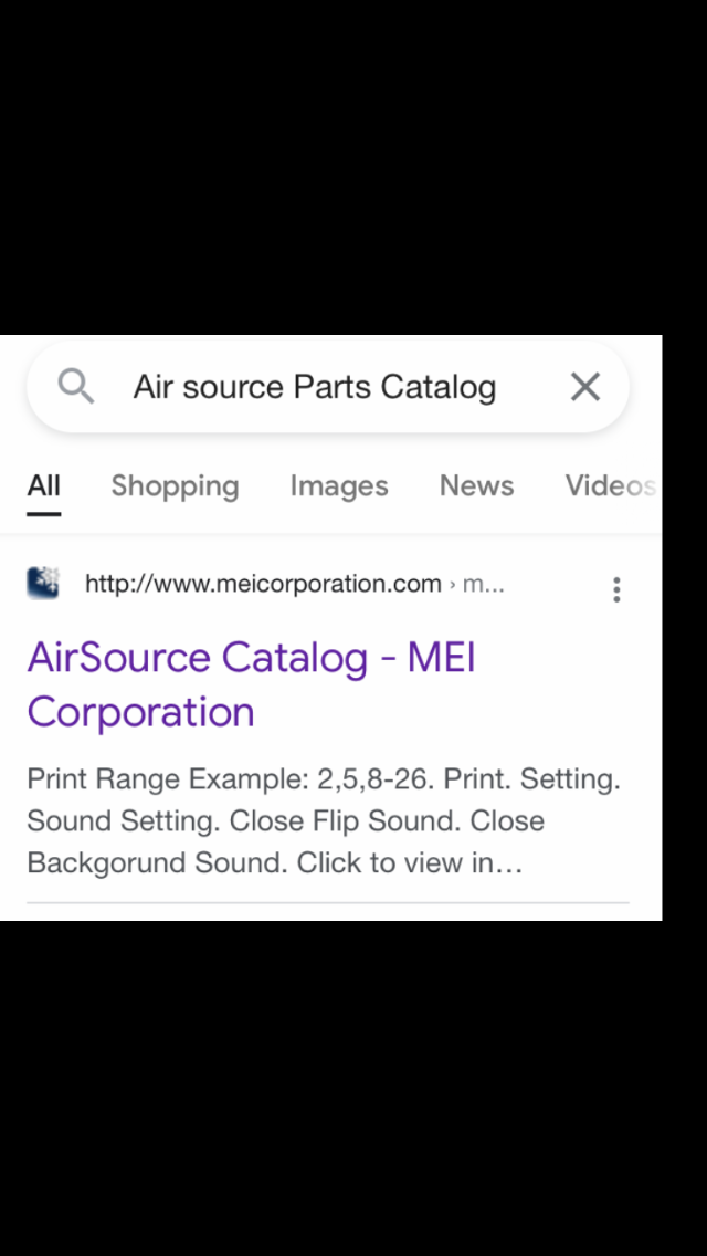

  7. Rideandrepair
    17,451
    56,621
    Aug 8, 2015
    C9CE1223-8AAC-40A1-8E8F-A19126B74A1E.png Here’s a great source. If you go to this website, you can get their catalog without signing in. Page 261 and up, has all the Sanden compressors, different heads, and connectors.
    nikmirbre and spsauerland Thank this.
