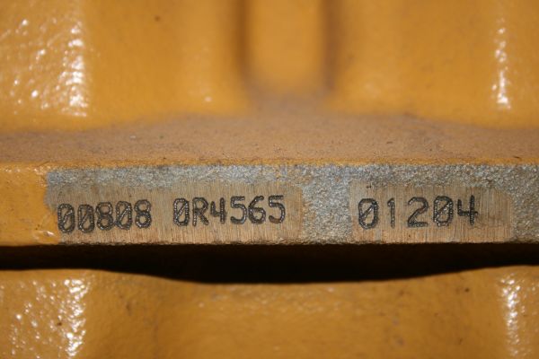

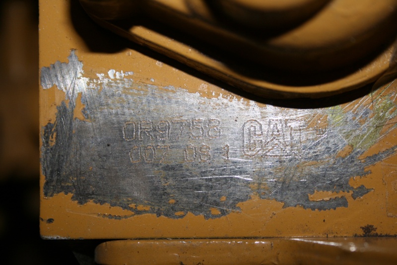

    I have no idea, on the top front of the head besides the word "CAT" are the numbers OR0758 and below that are 007 US 1 and a casting number on the side of the head 7C3346X with a 8 below it. IMG_7009.jpg 3F13If3J75L65K15Hcd294abb03ce0c961e9f.jpg 3Fd3I23Hb5Lb5K95Ffd29f7457322fc961e2b.jpg
  9. SmokinCAT
    SmokinCAT Road Train Member
    1,773
    1,487
    Oct 20, 2010
    Hillsboro, OH./ Adrian, MI
    Those are just part numbers for the head, your best bet it to call your truck dealership and have them run your serial number then they can give you the engine serial, that eliminates the guessing.
  10. PacTow
    PacTow Bobtail Member
    7
    Mar 4, 2013
    Spokane Washington
    I wish I could but I bought the motor as you see it, has a rebuild tag saying .020 on the rods and mains and STD bore. I called my local Cat dealer and all they could tell me was that the OR meant it was rebuilt. ??? Do I need to tear it down to figure this out? IMG_7015.jpg
