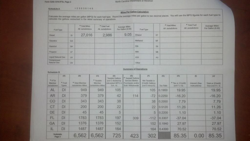

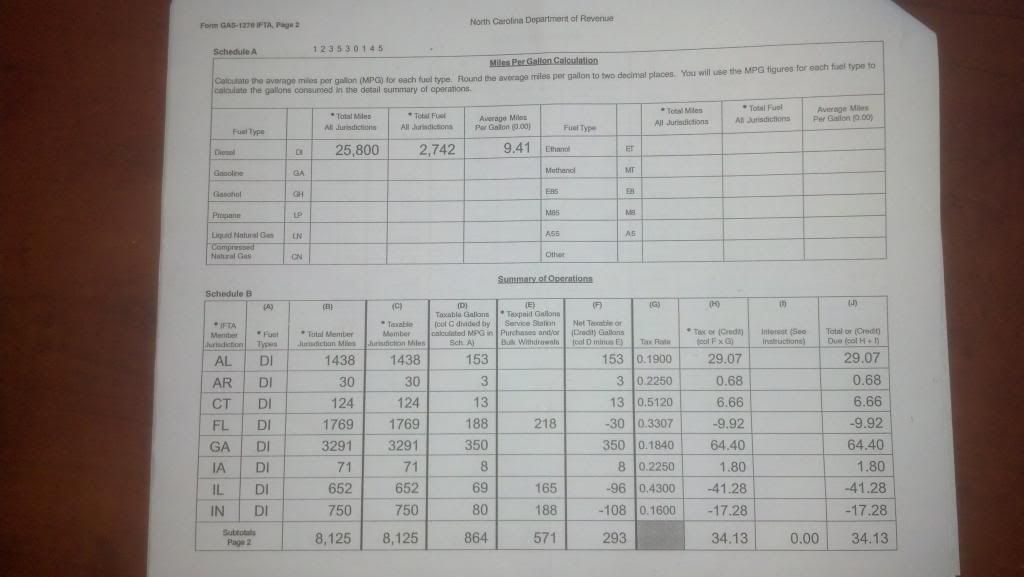

    1998 Volvo 770 with CAT 3406E 13 speed, 3.36 rears, Michelin X-One Energy drive tires, XZA steers, Centramatic Wheel Balancers, TST Tires Pressure Monitor System, Real Wheel Aerowheel Covers, Air Tabs, Pittsburgh Power box, Walker Megaflow Mufflers, Pittsburgh Power exhaust manifold/larger turbo package, FASS, Fleet Air filter, Mobil One 5W40 synthetic oil, MicroBlue treated Wheel Bearings, MicroBlue treated Rear Ends, MicroBlue treated Transmission, MicroBlue treated Turbocharger and MicroBlue treated Main Bearings.
    1st Quarter IFTA = 9.41 mpg
    2nd Quarter IFTA = 9.05 mpg
    I do power only moves with all kinds of trailers from brand new empty dry vans to oversize/overweight construction equipment and I do bobtail some between loads. Most of my heavy oversize/overweight moves are usually during the 2nd and 3rd quarters that makes my fuel mileage drop from the other 2 quarters. I drive 57 mph and I am very displined in my driving habits to be very conservative that with my mechanical mods has changed my operations fuel mileage from the low 6's mpg to my current 9's mpg.
    You would be surprised how much it adds to the bottom line going from low 6's mpg to 9+ mpg.
    Note: I also have solar panels to keep batteries charged and reduce idling.
