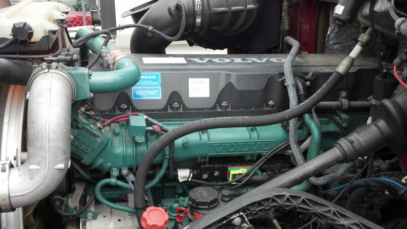

 This Volvo D13 is maybe the best motor on on fuel on thr matket .My dash today, shows 8.8 mpg, after a trip from Toronto to Laredo, Tx; temperatures below freezing first 10 hours, 18,000 lbs load/dry van with wind skirts; Volvo 780/2008/Volvo D13: limited to 65 mph,(Ontariio law).But after dozens of measurements from pump to pump,I would say the dash is off about 0.3 mpg.Bought it new in ,'07 original motor 1,253 000 miles ,as you can see,still running great .
 [UR// http://imgur.com/aZk0lUb[/URL]  Attached Files:Last edited: Mar 20, 2014
