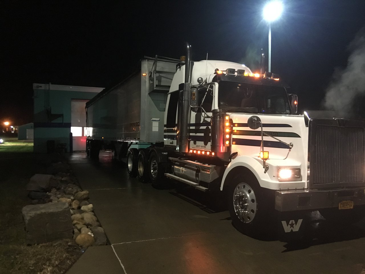

    B573A75D-AF54-47DA-9388-108EAD817DE4.jpeg My vote would be for a heavy spec Western Star 4900 with a pre emmisions CAT or Detroit.
    46k rears , 18 spd, high logger type front bumper with H rated 24.5 rubber. They’re built like tanks, sit nice and high for better ground clearance , and they ride nice. My second choice would be a similar KW T800 .
    This is ours. I’ve driven them all in the last 32 years and this truck is a tank. They all break , but This truck is the toughest I’ve driven and hauls 107lb ,500 miles a day and goes off-road in landfills up to its axles. Never snapped an axle or broke a rear and it handles the weight
    Very well
    ur2ez83 and SavageMuffin Thank this.
