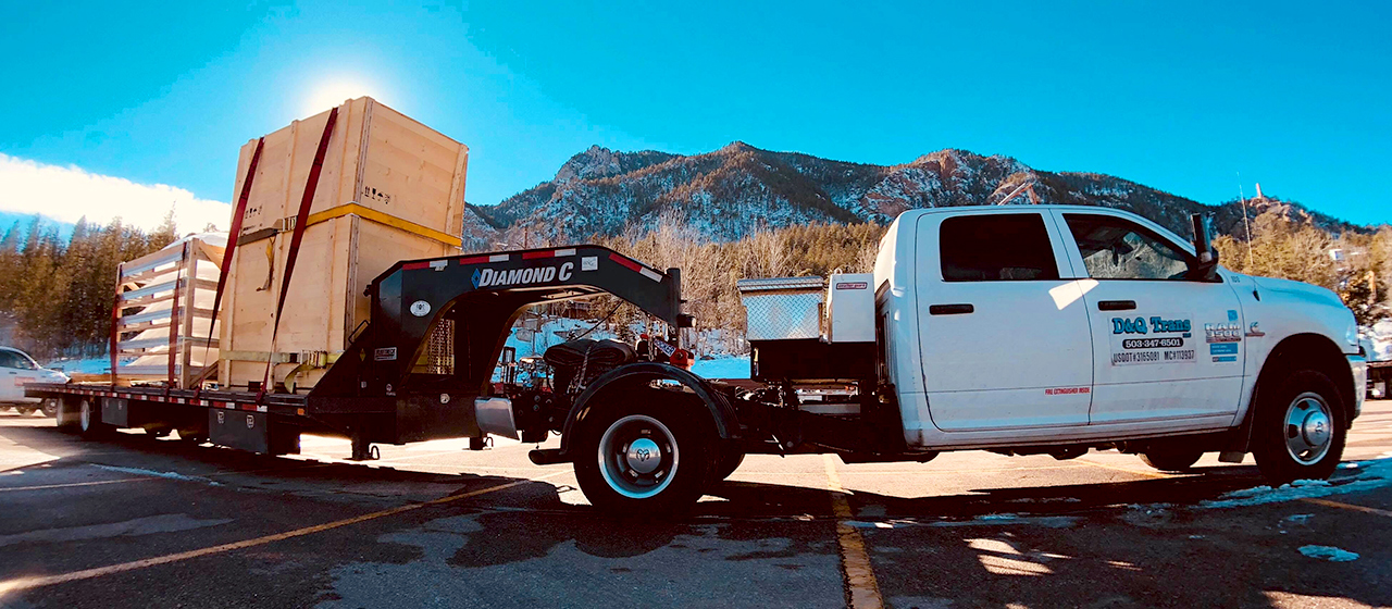

    Did it looked like this one?
    Gonzo1300 Thanks this.

    A tandem axle on a 40ft goose neck trailer comes in 10-12-16k weight rating.
    Assuming a 16k per tandem axle and a total of 21k gross,
    the single drive can be loaded with about 4k probably and the rest on the steer axle.
    It's an educated guess, not a scientific white paper.
    Does it answer your question?
