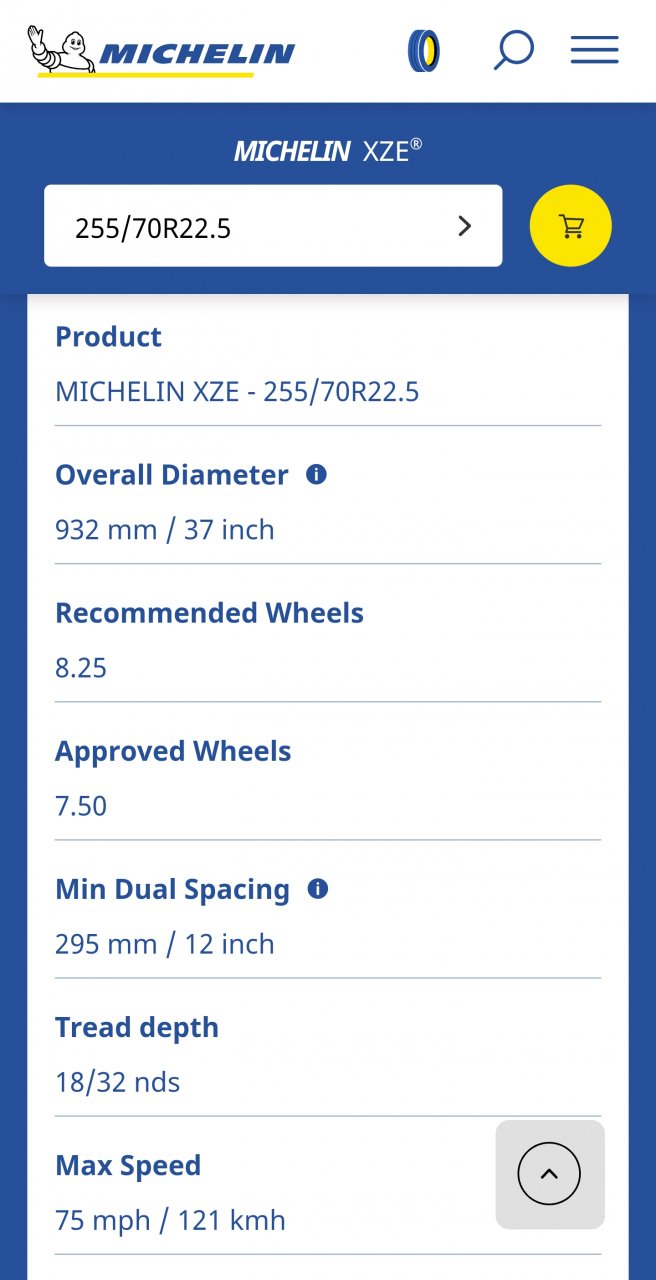

    Why is the Michelin 75?

    Because the carcass passes the north american dot laboratory testing standards for static unloaded spinning at that speed. Meaning it will not throw off its tread cap or blow out the sidewall but that does not mean the tread compound used for that size will hold up for wear. You well be lucky to get 100,000 out of an XZE in those sizes at that speed. 19.5’s are even worse. They well have all kinds of funky wear that will leave you chasing or tail finding out what is wrong with the equipment. Rv’s generally sit and tires rot before they wear out. Tire manufacturers know this and after the three big recalls caused by tires being kept in service to long because they did not wear out and people driving 70+ mph on 10-20 year old tires they started making them wear out faster on purpose.

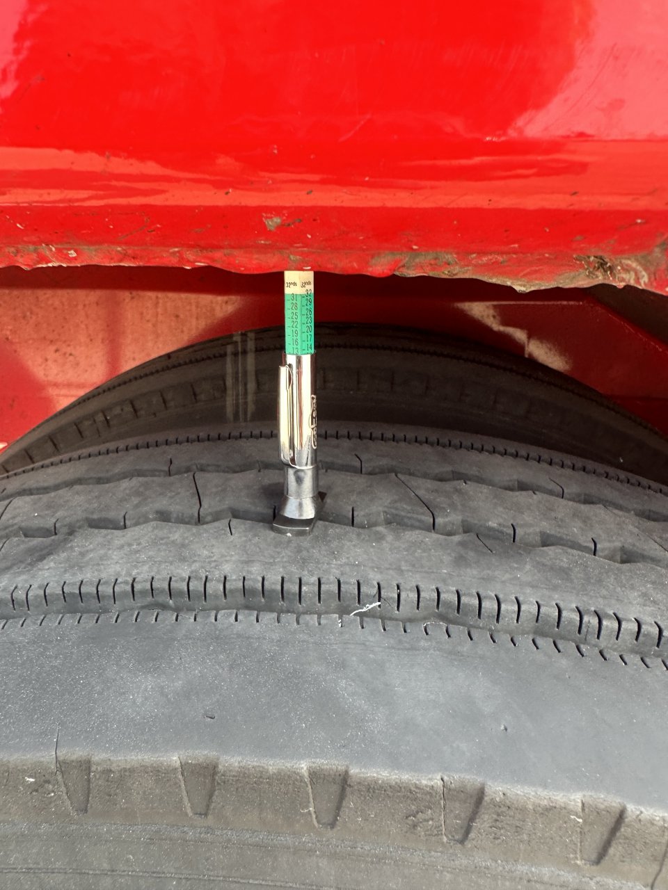

    This is a standard size for carhaulers drive and trailer positions. I have run the Michelin XZE for 8 years with the Hendrickson Tire Max system set at 110. I generally get 250,000-300,000 miles on my trailer tires running 65-70. I also use centering sleeves and centramatic balancers. I have 160,000 on these and I guess they are good for another 100,000 or so. IMG_0109.jpeg
