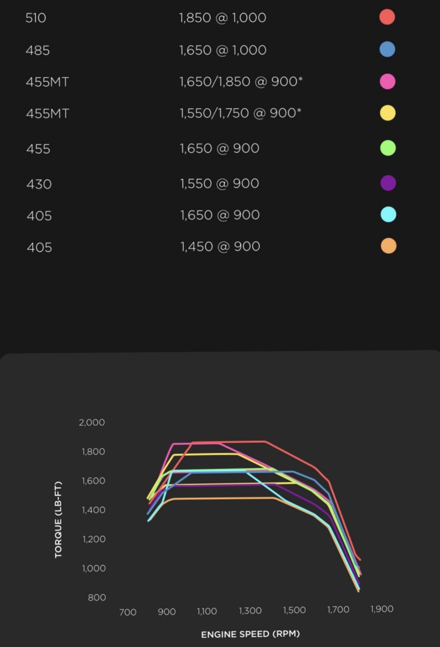

  9. Long FLD
    Long FLD Road Train Member
    11,907
    48,924
    Mar 4, 2015
    Just for reference, you can see the torque fall off at around 1400rpm.
    650cat425 and The Wiz Thank this.
  10. The Wiz
    The Wiz Bobtail Member
    30
    9
    Jun 4, 2020
    Yes I see that thank you. That is why I'm worrying about a fuel economy drop
