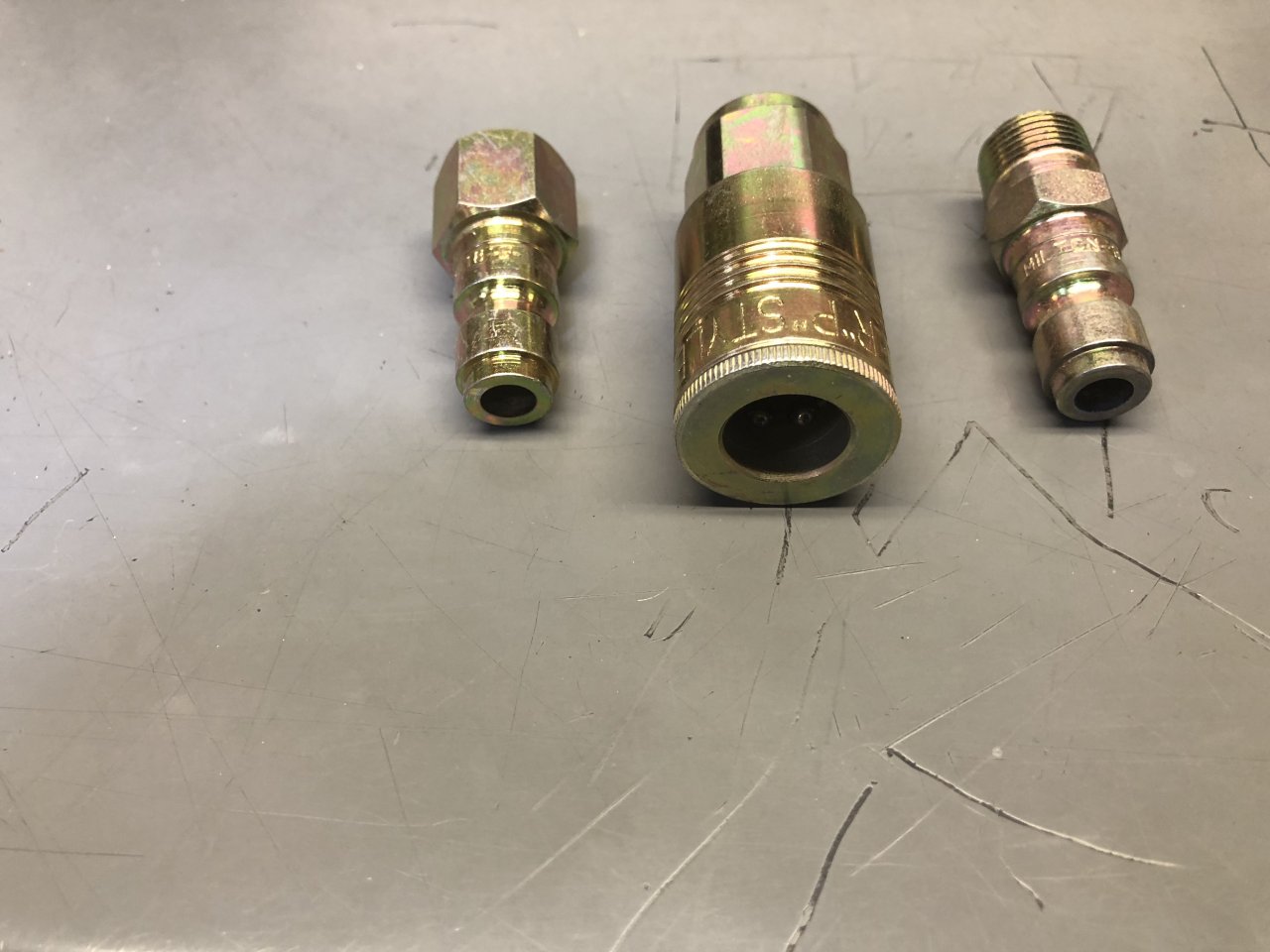

    35D86BC8-7627-43FA-AA1C-5E51EC67D4DB.jpeg You could always use 3/8 high flow fittings. No law says you have to use the standard home/shop 1/4 fittings.

    Most chucks are 1/4 tread but they make the 1/4 tread 3/8 fittings to work for that. The one on the left side of pic is just that. Most 3/8 hose are 1/4 tread and 1/2 hose is 3/8 tread anyway.
