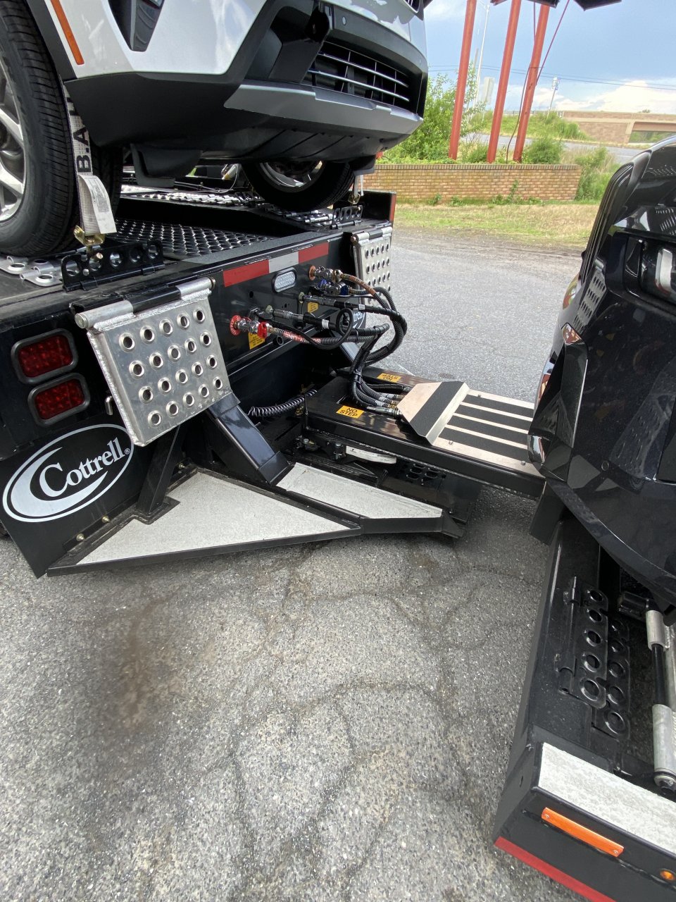

    Fifth wheels on a stinger don't slide.

    Most of the 75' equipment does, and a few of the 80' do.

  11. carhaulerjeff
    carhaulerjeff Light Load Member
    203
    588
    Jun 8, 2016
    IMG_8492.jpeg mine slides 80 foot when slide in. 82 foot all the way out
