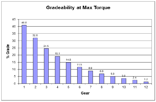

    Here's what I did.
    Engine make and model? Monkey method. I follow several peers on various social media whom I believe are credible. I watch the ones that are having the most success and least problems with their choice. Of course that will depend on who exactly you're following. In my case, the lead was with Volvo/Mack, followed closely by Freightliner. Past negative experiences with the dealers of the latter ruled them completely out for me. Too many sad breakdown stories from Paccar owners, so not even in the running. Not enough info on other brands, and I don't particularly like their cab construction or layout, so not considered either.
    Then settle on the choice within that platform. My mindset is get as much power as possible then plan not to use all of it most of the time. Mack was the value choice for me, and I am sold on the new turbo compounding setup. So that leads to the MP8HE 445/1850.
    Tire size low-pro 22.5 because they are the most plentiful when you need one.
    Transmission type is next. I am also sold on the benefits of automated manuals. I was already a big fan of Volvo iDrive over others just from rental units I've driven. Mack mDrive is the same thing. The only choices just add deep reduction creeper gears that I don't need. Standard 12 speed is the one.
    Drive axle ratio choice depends on tying optimum engine rpm with routine road speed. My engine choice has it's sweet spot at 900-1250 rpm. I got a performance analysis done for 65 and 70 mph. The 2.47 ratio nails it. 1069 rpm @ 65 mph, 1151 rpm at 70 mph.
    Once you've optimized engine sweet spot to road speed, ideal fuel economy is also achieved there. That's not a value, it's a range. The exact number you get depends on trailer configuration, route, and so on.
    I keep bringing up that performance analysis because it's packed full of predictive information. This is one of several charts for mine, and gives an idea of hill climbing performance. It's based on a gross combination weight of 60k, which is actually a little low for my operation. We're usually loaded at 65-80k. It was close enough for me to see my spec will be adequate for 99% of the routes we travel, but definitely won't win any races to the top of Moneagle, Fancy Gap, or Jellico. I can live with that, and experience shows it makes almost no difference in total trip time when this truck climbs a hill 5-10 mph slower than my old KW. The remarkable thing is that the new Anthem chugs up the hill pulling just as hard at 900-1000 rpm (as it's designed to do) as the 15L CAT did at 1600. At first it just doesn't feel right, but you get used to it. These are the maximum grades in each gear where you won't lose speed while holding the throttle to the floor.

    They are tied together to a point. The buyer will set some priorities as I described. Something else will be more important to others. I also think a lot of buyers spend too much time hand wringing over differences that really don't matter all that much. Or apply experience with an older platform to spec something out that doesn't make sense on the new one. In my opinion, the sweet spot of whatever engine you choose and tire size dictates the rest. Anything deeper than that is either just some kind of one-off operation requirement, or lunch counter tale.

    I am somewhat allured to the idea of getting a new truck, especially after testing T680 with X15 , because of effortless huge improvements in mpg. From 6.5 to 8.5 mpg when loaded ... it was 65K lbs on gross. I did nothing different about my driving habits...which I hope are still optimal for what I do. I am also glad that you are ok with the auto transmission. I more or less thought that it was something that benefited megas who put very fresh recruits in their trucks. Perhaps, it is better for someone like myself to change the habit of watching the rpms not to ever drop below 1300 on these newer engines. Even on those smaller Ohio hills, it felt awkward to let it run on 1100 rpm while climbing.

    It took me a couple times to get used to getting a full, hard pull at 900 rpm when pulling out to pass for example. It is deceptively quiet, which is another feature of a brand new truck that hasn't already been beaten to death for decade and a million miles.
    What you said about the fuel economy was almost my entire cost justification. When fuel costs me $3.25/gal, I am literally taking money away from EFS by purchasing less fuel then sending it to Mack as a monthly payment. That is my break even, not counting less repair and extended maintenance intervals. If fuel goes higher than $3.25, I am increasing my profit with the new truck versus the old one.
    Regarding the programming: You can do anything you want. Mack supplied me a 40 page power point deck describing all the possible programming options. Half of them are features more suitable to something else. Dump trucks for example. Or tanker haulers that need to run a PTO driven pump. More options than you even thought you needed. Volvo and Mack have some configuration sets that cover a dozen or more parameters in a group, in order to simplify it. Then you can go into those and tweak some things if you want, but usually the package includes the best options for the desired group feature. I can also have those parameters changed over the air. Don't even need to take it to the dealer. The base package only includes a couple changes the first two years, but you can pay to get more. An example of someone that might do more changes would be a truck that goes in and out of Canada. Hit speed dial on your cell phone and get your max speed dialed down before you enter Canada, then call back and get it turned back up when you return, and never set foot in a dealer. I am sure the other brands offer similar options and features.
