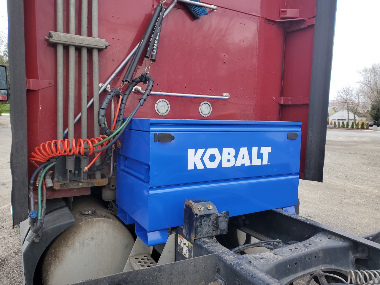

    If you own the truck, you could get a jobsite box and mount it behind your sleeper. May require moving the trailer hookups which can involve extending the air and electrical lines.

    Looks like you are stretched out. One that deep wouldn't fit my truck. I bought a cheap Tractor Supply truck box first time around and it rusted to bits in a year. Now I have a better aluminum one and it's holding up fine, not that big though.
    How much does that weigh empty?

    Box is steel and weighs maybe 50-100lb empty. Think it measures 2ft x 2ft x 4ft. Have it bolted to the frame through holes I drilled in the bottom of the box.
    Just have a standard t680 and it's a former JBS truck so big company specced. Did have to move my 5th wheel all the way back to keep my trailer (dry van) from possibly hitting it if I get the front of the cab up an incline and 45 degrees to the trailer. Also had to move the trailer hookups to the side fairing or the lines would almost get pinched with the cab at a 45 degree angle to the trailer.

    Uh oh, I hate to be a party pooper but if you drilled straight through the box and through the top of your frame that is a no no. At least that's what I was told. Supposed to only drill in the sides of the frame rails because the torque twist can crack the frame.
    Nice set up regardless.

    One thing for sure...that Kobalt box can carry the whole overhaul kit and tools for it...let's not forget about a tent if the overhaul would need to happen in an open air somewhere. With that box you're ready for anything anywhere and anytime. That's an ultimate setup for a self reliant owner operator.
