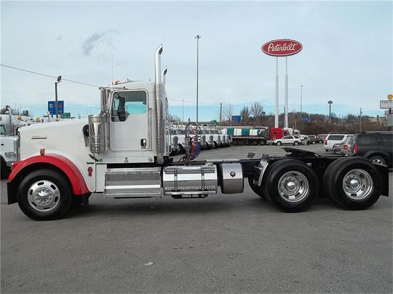

    So what is that sitting between the fuel tank and the tandems on this 2011 KW?

    i have a buddy with a early 2011 mack and it has a urea tank
