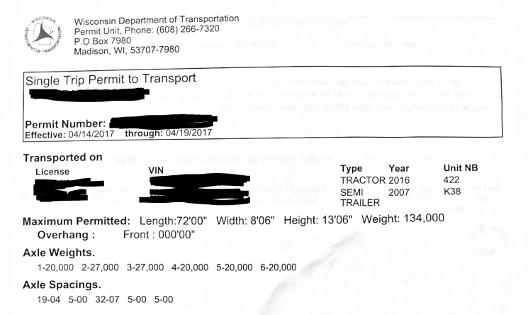

  6. Razororange
    Razororange Road Train Member
    2,475
    23,542
    Dec 20, 2011
    Milwaukee, WI
    This is from last year. Boss was worried the load would be heavier than estimated. I'm about 39K empty and the load was supposed to be 86Klbs on a 3 axle flat. Wound up only being 84K.
    Final loaded weights wound up at:
    19,760
    45,320
    57,840
    122,920 gross
    I permitted for 54K on the drives. 46K rears with tires for 52K.

  9. snowman_w900
    4,418
    81,024
    Nov 25, 2010
    Thats Interesting they will permit axle weights like that. I wonder how many guys they have busted for being over on axle or tire capacity. Its almost a trap or a dare.
