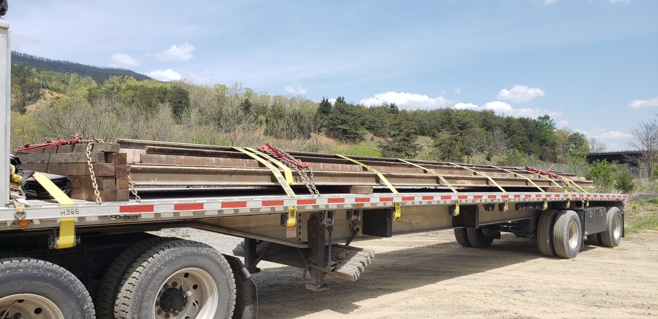

    He's not talking about a headache rack. He's talking about a bulkhead.
    Here's an example of two bulkheads. One fixed to the trailer, and one constructed to actually help stop forward movement.
    OP, I've never heard of a two-chain requirement. Not sure about that.

    Although it's Western Express, this is about the best description and example I could find on short notice of building a bulkhead/header/barricade:
    The headache rack, tends to do double duty. It's a weak protection, although it will deny it being appropriate for that purpose, but it mostly is used for holding securement gear (chains, binders, etc) and comes in many variations. Also, the one shown above by GPD, is another example of a header on a trailer, but it too, tends to be used to hold securement gear, but doubles as a header/barricade/bulkhead.
