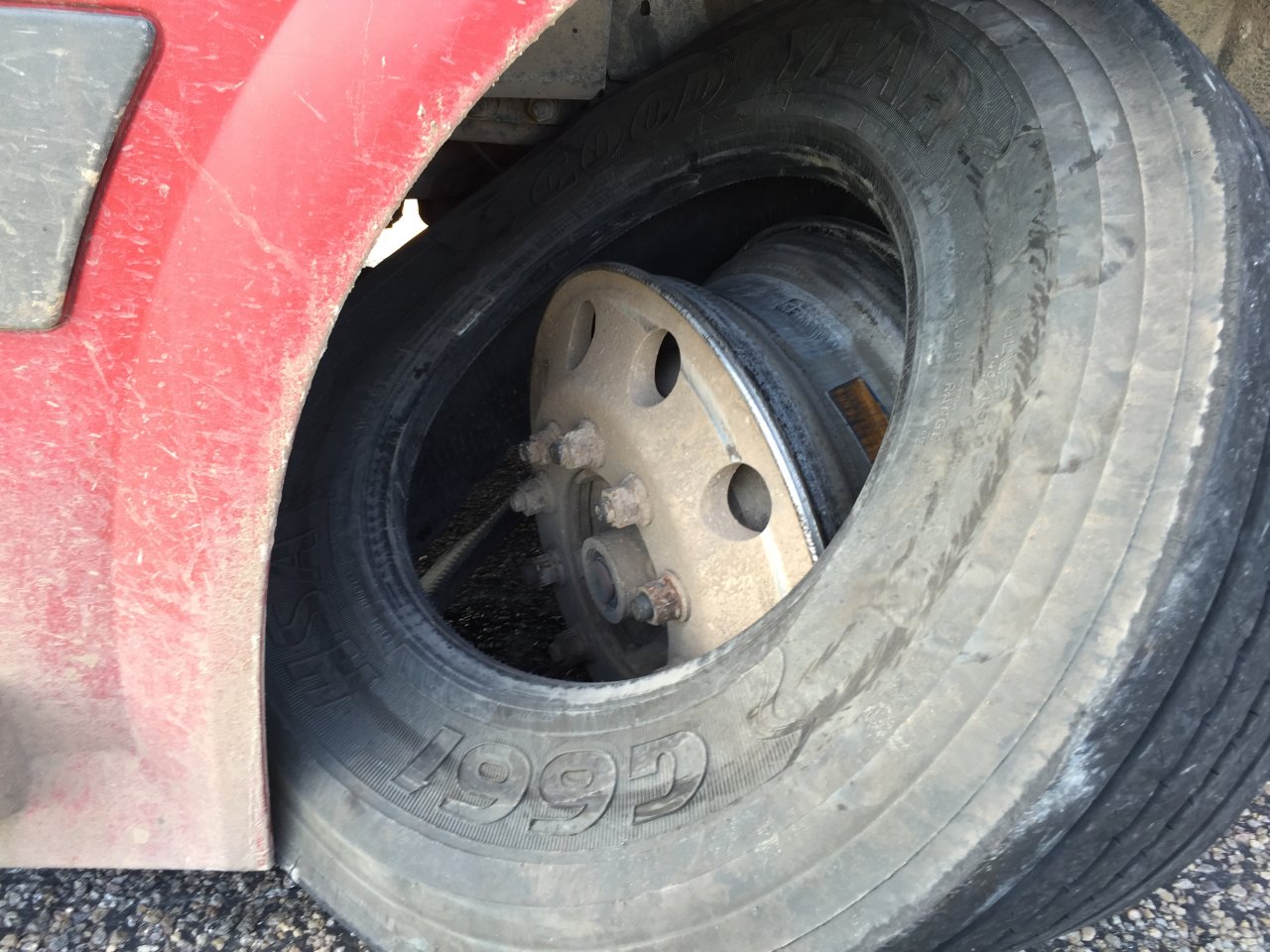

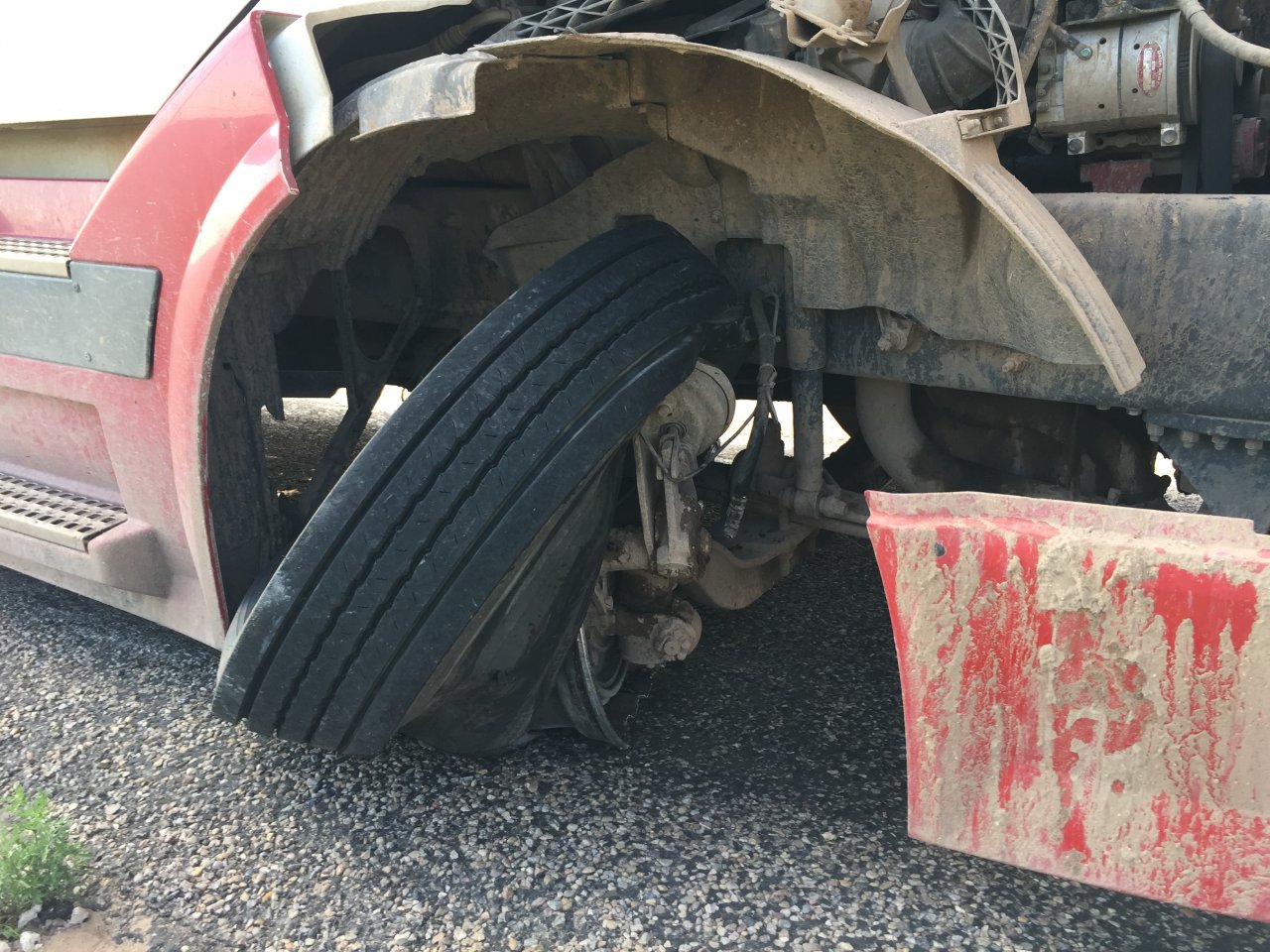

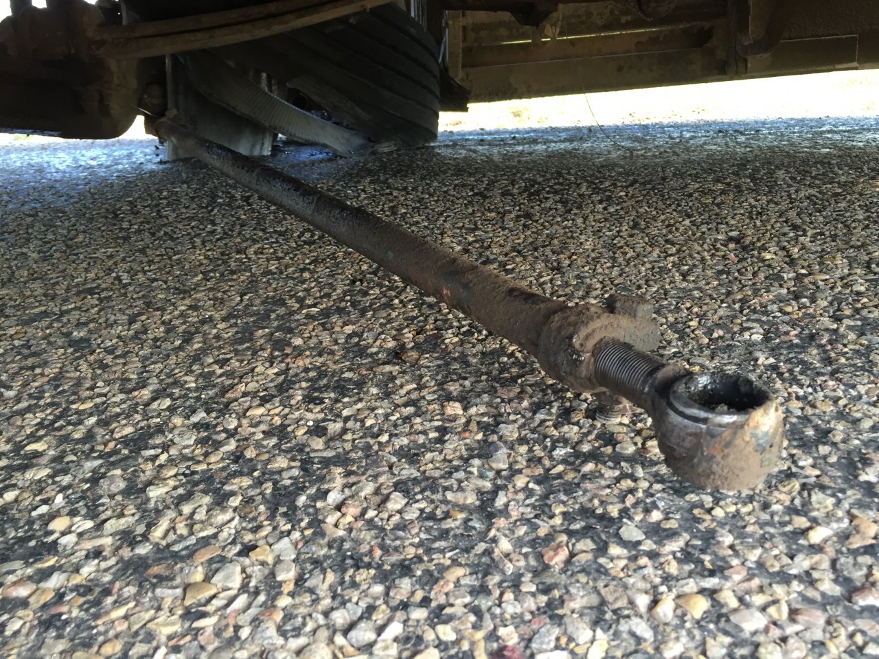

    image.jpeg image.jpeg image.jpeg This happened to one of our drivers the other day. Still not sure if the tie rod broke first, or if the steer blew first, but either way, it tore up a lot of stuff. 75 mph on a west-Texas 2-lane, and he kept it right in his lane, all the way to a stop. No shoulder, so it sat right there till the wrecker showed up. He got himself a new nickname that day..... "Tie Rod."
    I personally have never lost a steer tire, and I'm pretty meticulous about checking them, but I still try to keep both hands on the wheel at all times, just in case.
