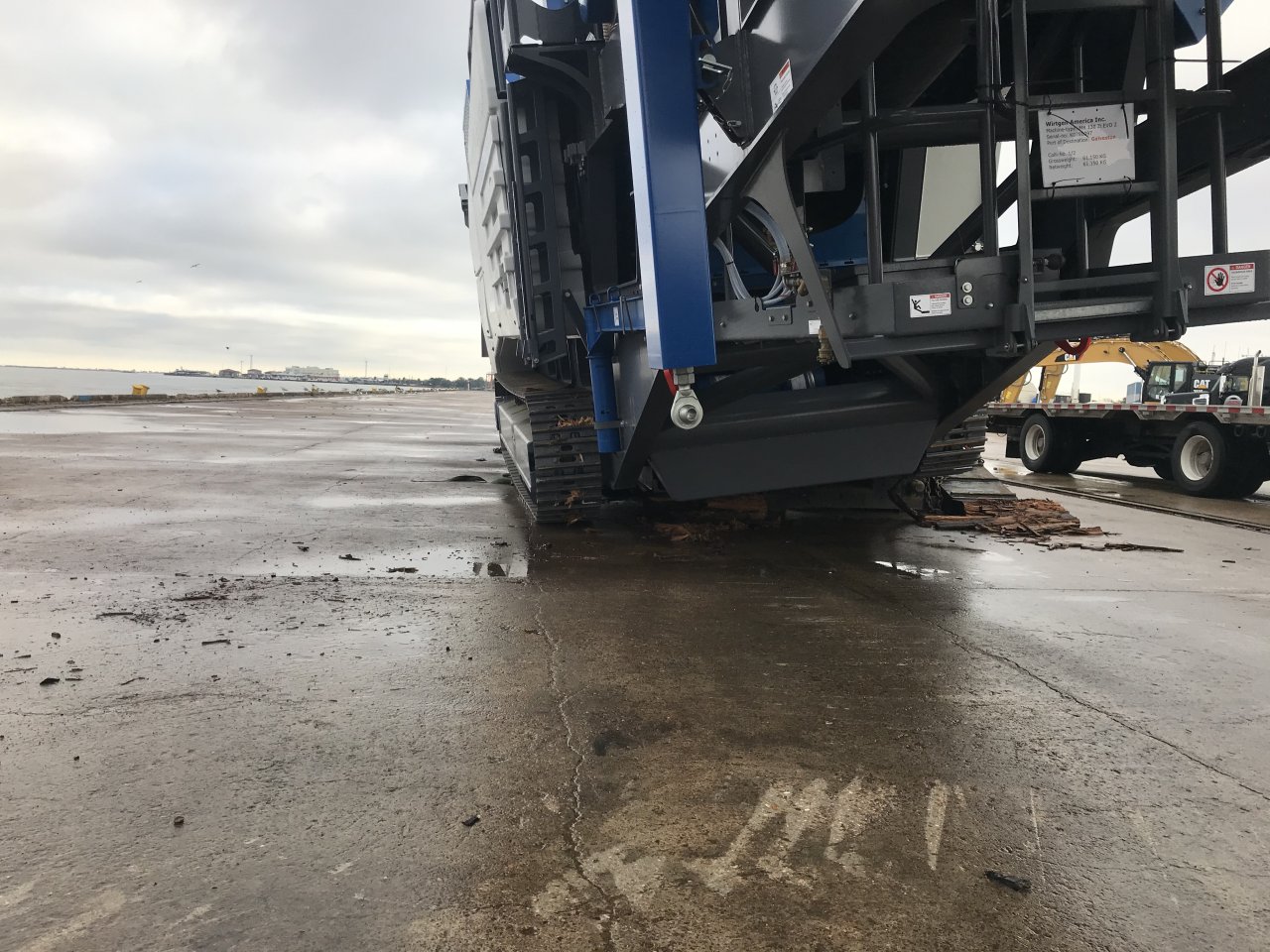

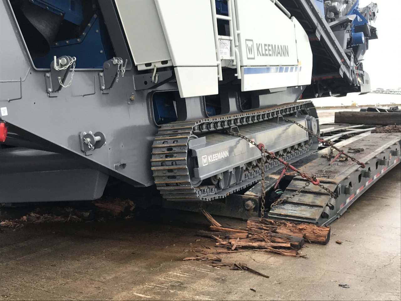

    A5045741-82C5-4ED5-9A2A-F433A66D89C6.jpeg You didn’t mention OFF-ROAD. There is a reason why many of your entry level box companies supply rookies with detuned, low hp trucks...to help prevent rookies from grenading the drivetrain. If you are running heavy equipment, you will see your fair share of mud. The more powerful the engine, the easier it is to grenade the drivetrain. And so, you have to learn to be gentle with the truck, especially on the throttle. No revving and dumping the clutch and making the chassis twist. No pedal to the metal while accelerating.
    I ran local for a construction, demolition company. So yes, you can do local. Don’t allow running local to develop bad habits. The company I drove for got busted when their driver had an escavator walk off of an 8 axle rig in the middle of a turn in the city. No securement and a class B driver.
    One more thing... you have to be able to load your wagon yourself. It’s not always easy. Some machines are so big and tall that when trying to line up to get on the trailer, you lose sight of the trailer 20 ft before you even touch the trailer. EE91E54A-CCD3-4C76-8B3A-FC7D7E174D00.jpeg
