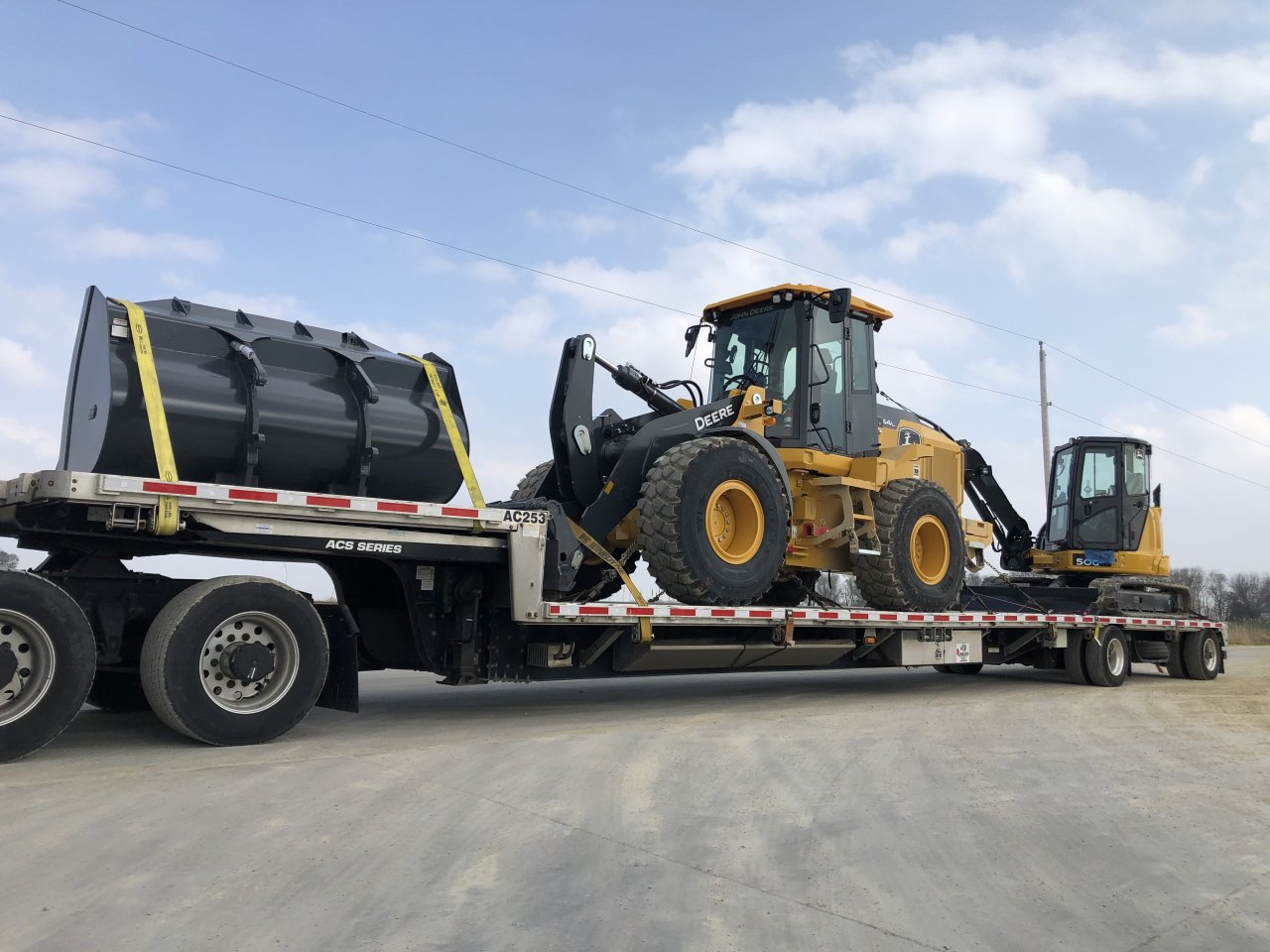

    Something else to ponder. Don’t take someone’s word on what your hauling weighs. Look it up on the company that manufactured on their spec sheet. You’ll also need the width and height. I only need four chains and a strap to be legal on the loader. Me nah !!! Let me put four 1/2 inch chains and 1/2 inch binders. Then I have to put an additional three more chains two in the read and one through the middle. This is done so that it can be bound down to not exceed 13’6”. There’s a system that I have to follow in order to tighten them and loosen. If not then you’ll get to the last few and you won’t be able to budge them loose.
    knowing and learning your trailer on load placements is a top priority. It all starts there. You don’t want to get loaded and then go scale and find your heavy on your drives or over on your rear. Then your moving equipment around at the truck stop and that’s a busy place to be moving high dollar equipment. To many bad things can happen.
    Measure your load. I measure my load four or five times just to make darn sure and then I look in my atlas for low clearances along my route.
    learning experience for me. Load in the pic was 13’5” high. Made the first drop and I went along my way to make my second drop (the loader). Pull into the coop. Right lane comes on. Well crap I know what they want. I didn’t remeasure the height of my load I was now 13’7”. I explained myself and told him I was new. He pulled me aside and advised me to measure every time. Yes sir I completely understand that now. I was able to tighten bi fees back down 13’6”. So I was good. He was watching me so I couldn’t just dump the air.
    open deck is something new everyday. Not everyday is equipment/agriculture/machinery day. You’ll have backhauls. I’m loving it. Kinda wishing we ran all 48 maybe something will change for me.

    Unloading the little excavator gave you back 2" of arch? Or was it more of a combination of suspension and arch? Either way, interesting and useful to know.

    Suspension. He measured with a tape. I measured with a pole. So he could’ve been off a little and I could’ve had some bend in my pole trying to make it short as possible. Either way now I remeasure. And make sure I’m on flat ground.
