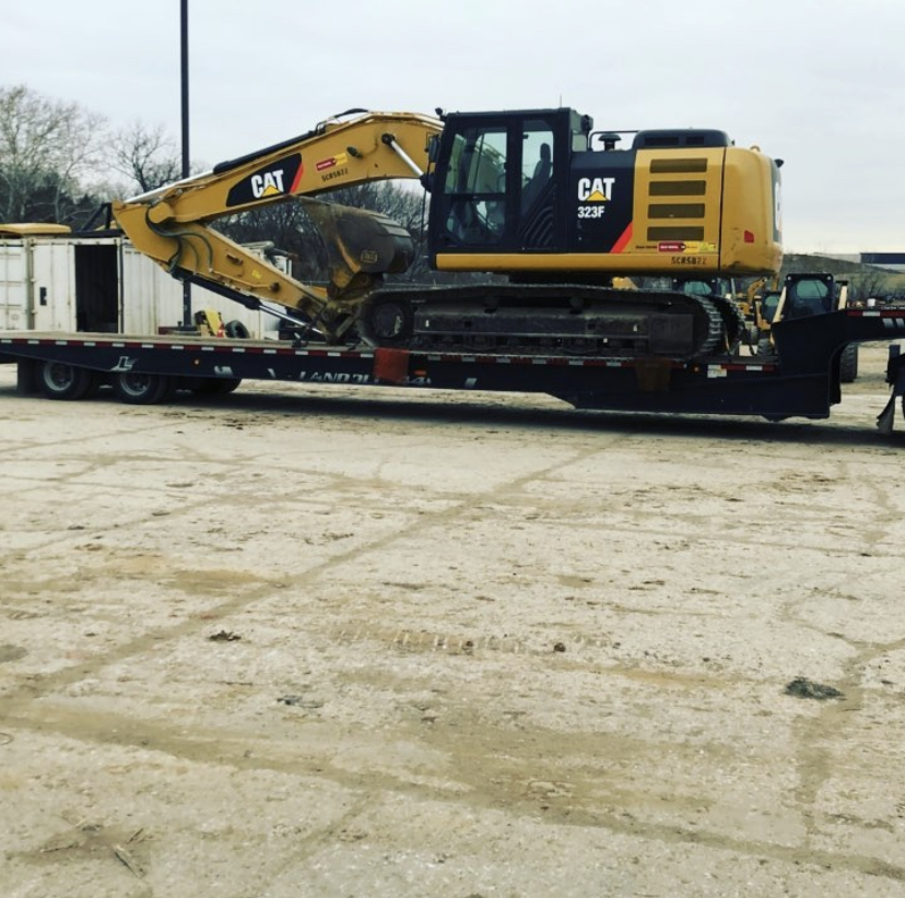

    A821DB60-9C2D-4F98-99FD-929469C6C85E.jpeg Here’s close to 50,000 lbs 3 feet off the ground. This is a very top heavy load. You have to know your load and how it’s going to react on different trailers.

    Chriskc, what's the most you've hauled with that trailer? That seems like a lot for a landoll with the full bed tilt. I assumed those had a lower capacity than the landolls where only the tail dropped, but I could be mistaken. And i can't find a sticker or plate on mine that states the axle capacity.
