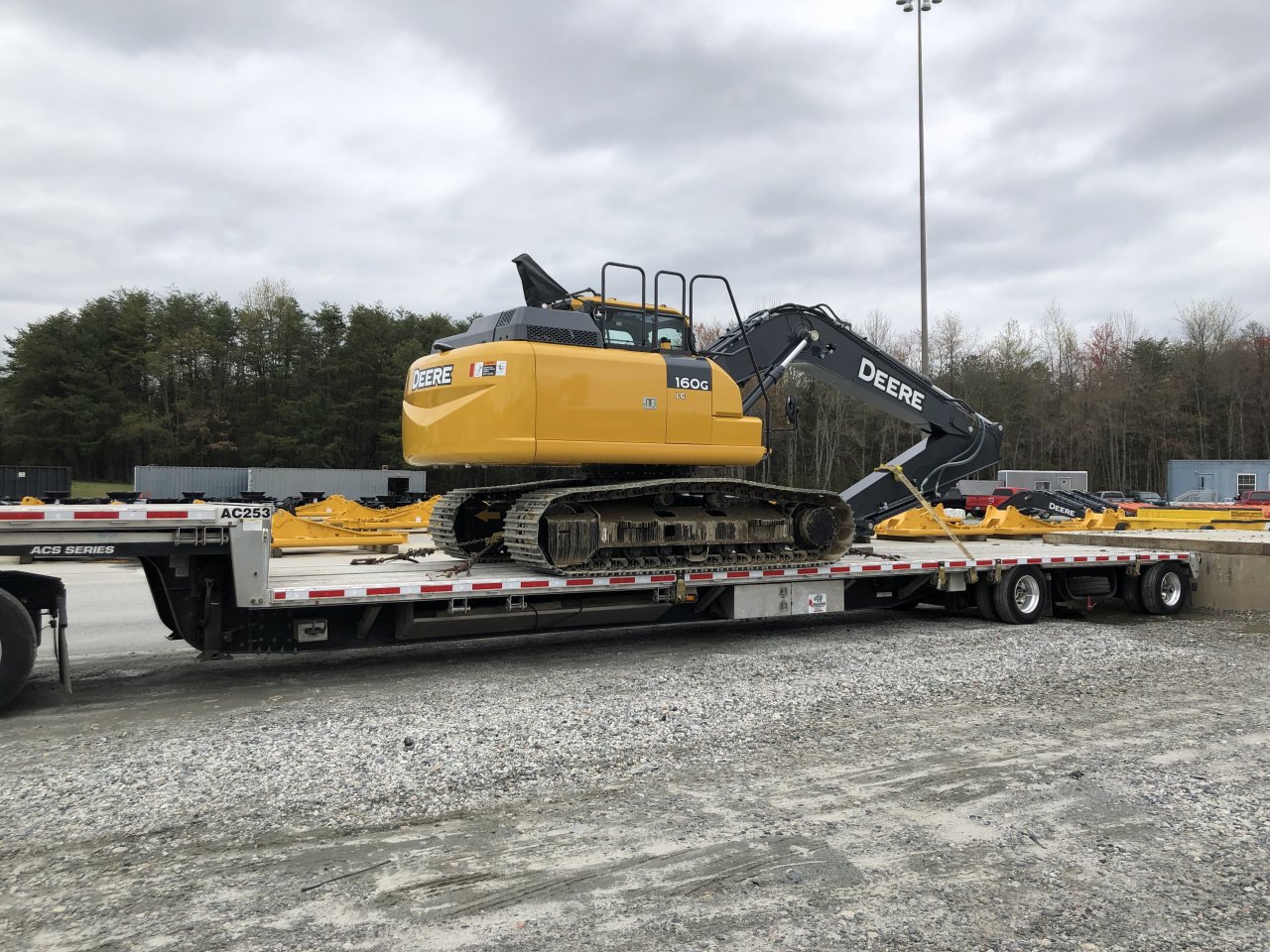

    here’s one for comparison loader vs hoe on the same stepdeck OS load by a few inches. We used to haul 210 on this trailer but now we are limited to 180’s and lower. This is a 160.

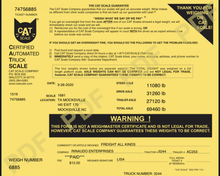

    The scale ticket. Pardon my ineptness of technology and my non texting thumbs
