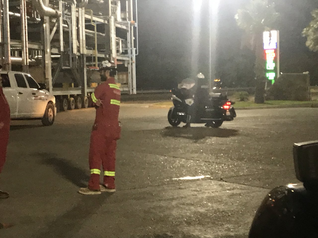

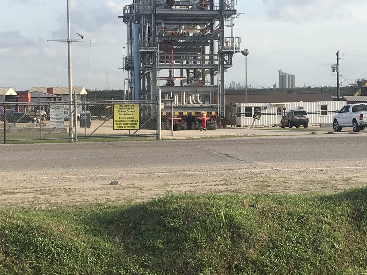

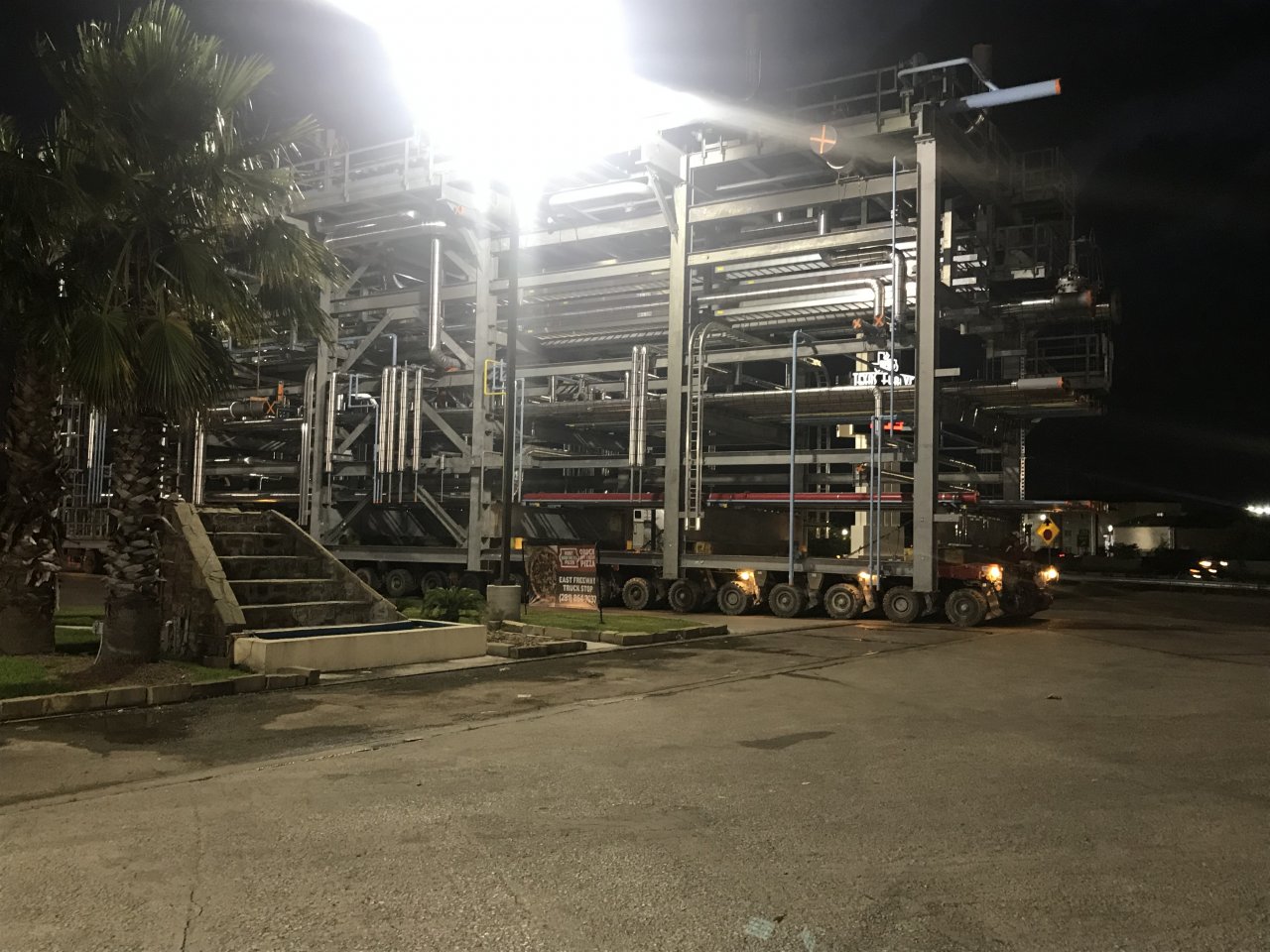

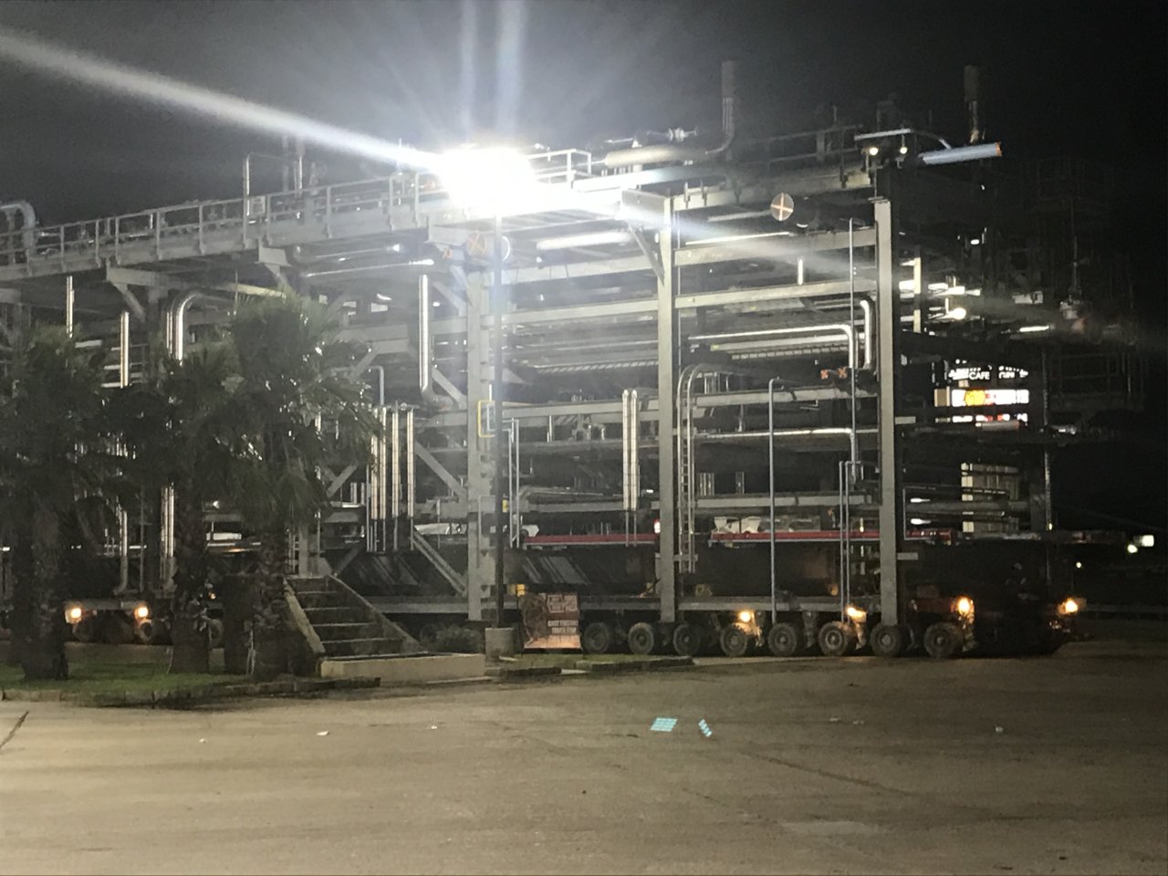

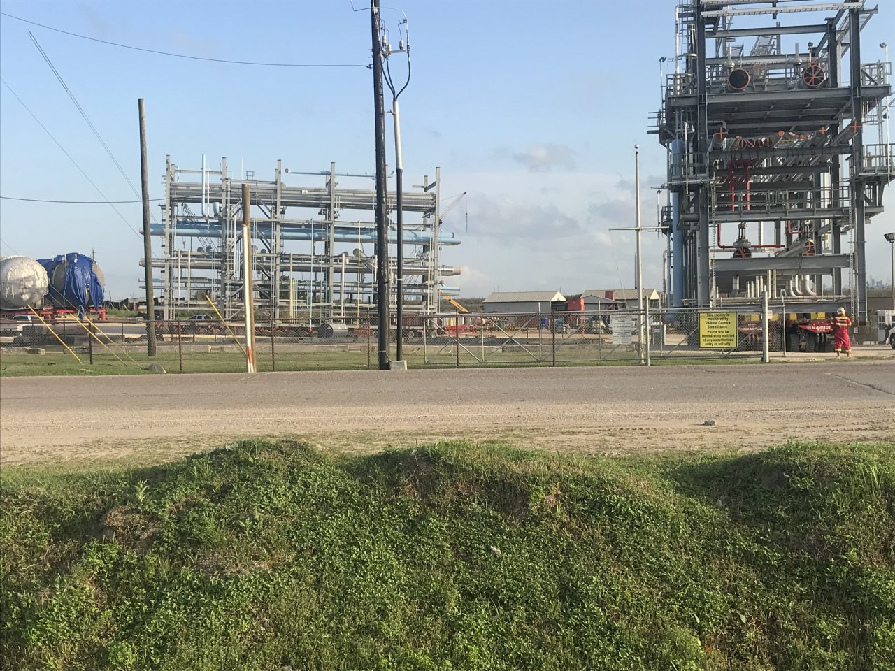

    Every week or so, they have to offload these loads, run them through the truckstop parking lot to the eastbound I-10 service road, and go westbound, cross the interstate, and reload them back on the barge. One of the loads was near 70ft tall, according to the motorcycle cop. Big freakin load.

    In most cases it is not the roads into the site that require a trailer change but the maneuverability inside the compound. A SPMT can if properly operated turn circles within 125% of its own length while hydraulically keeping a load level and plumb on uneven terrain.
    In the move by Edwards the SPMT (or Goldhofer with add-drive) once inside the site at somewhere near 160 or 200 ft long, 16 or 17 ft wide and 23 ft high is much more maneuverable than 345 ft long, 19.5 ft wide and 19 ft high with a turning radius of 500 ft or more.
    They set up the gantry crane at a location about 8 miles from the site as what was probably the closest location accessible by the road trailer with the height change not being a factor. This also meant that the crane could be left up for the following 2 moves and would mean that the road trailer would be back to reload about a week sooner on each load.
