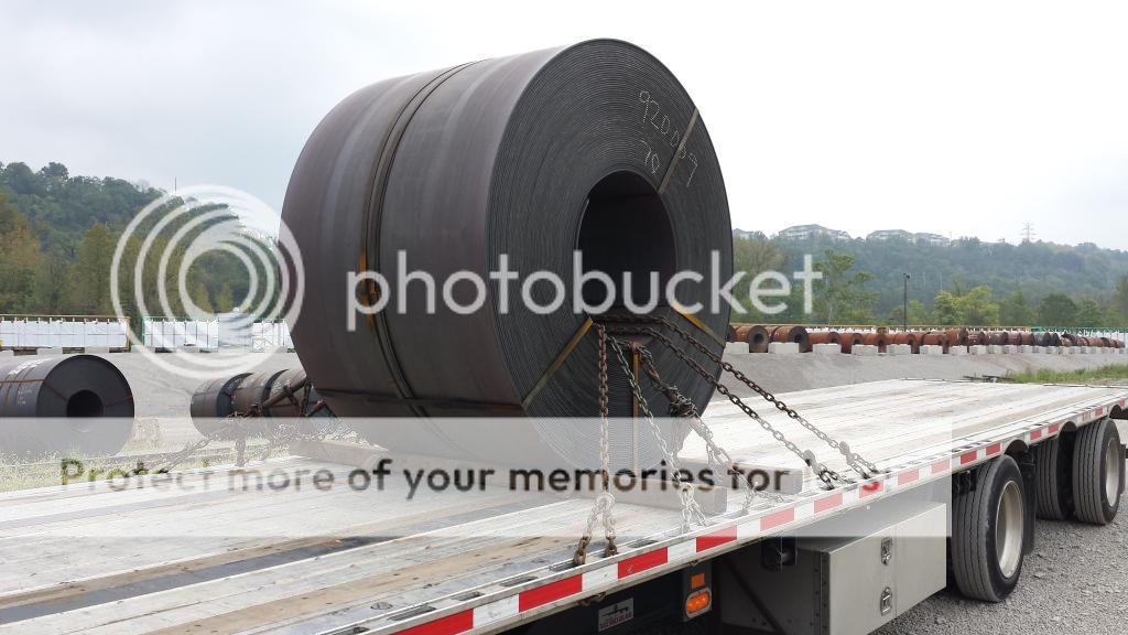

    I've hauled several 40 - 45k coils and only used 3 racks to hold my lumber in place. Never had any problems.
    This was a 42 or 43k coil.

    i'm curious though. instead of 3/8 chains. would it be doable to use 5/16 g70 chains. and put 2 straps over the top in a X pattern???? or an extra chain as compared to that pic.
    don't do heavy haul. so 3/8 chain isn't part of my equipment. pulling flat instead of a step now.
    thanks for that pic, hurst.

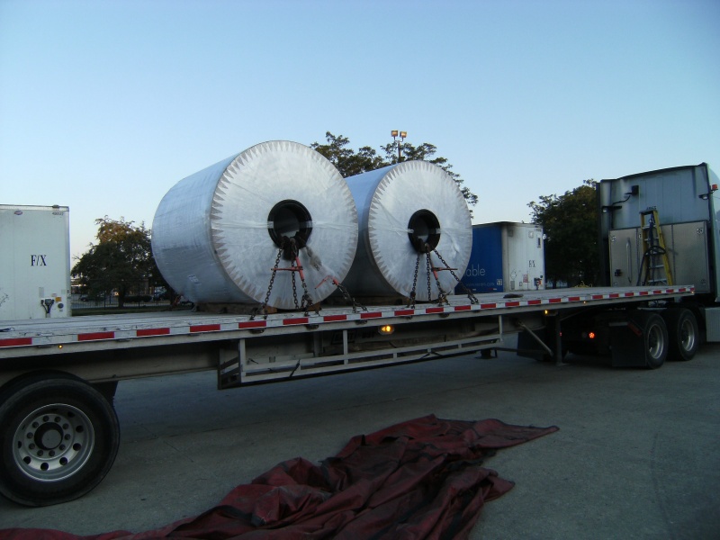

    Each of these coils was around 24k

  8. TripleSix
    18,622
    130,527
    I assume you are referring to that pic that Hurst posted. On a suicide coil, straps would just be as useful as decorating it with ribbons and paper. I would throw another chain through the eye. On a shotgun coil, I would throw a couple straps over the top.
