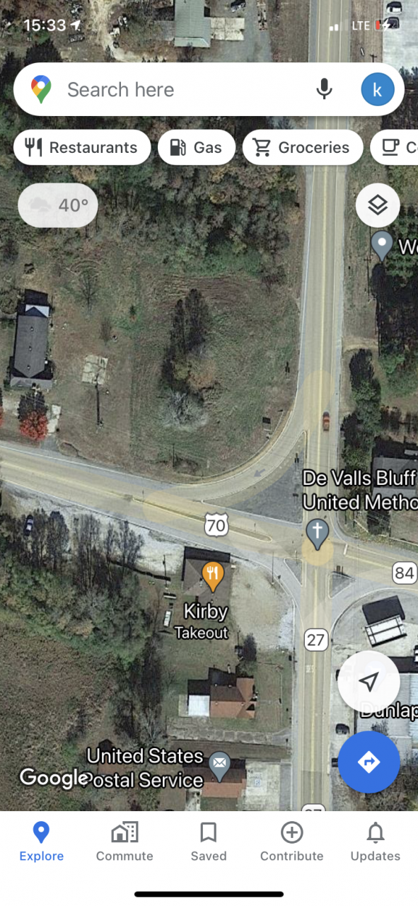

    How? Does google maps drive your truck or do you? Everyone that says “an atlas is the only way to route a truck” is behind in the times.
    I’ll be heading out in the morning at 15’11” wide and 100’ overall with the wide part at the end of a 70’ double drop stretch.
    Because I went turn by turn over my route with google maps satellite view I know I will probably have to wrong way this left hand turn in Kirby, Ar to stay on us 70. The signs will make it to tight with the island layout. What atlas could I have found that information in? 9ED01AB7-1170-4DA2-AA0D-03BFED9847EE.png

    The view is old, more than a few years. not on a main road. 1 was an o/s load, I dropped the load at the truck stop and bobtailed down , the satellite and Google map showed it going through, it did not. There have been others out in the country.
    kylefitzy Thanks this.
