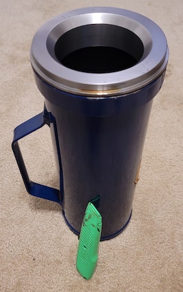

    Everywhere I went (TruckPro, dealers, etc) had no idea what I was asking for. The Chevron distributor had the right stuff. I used one of those bucket hand pumps like you use with gear oil to dispense it. It has the texture (and looks like) that runny banana pudding that seems to be on every buffet dessert table. Wouldn't hurt to save a few bucks on the pump and scoop it out with your hand, if you had to. The pump is a lot neater though.
    Also save yourself some grief and get the right seal driver tool. Whatever seal you buy will have their tool number printed right on the package. You'll probably have to find it on eBay. They give them away to shops that order tons of seals, but when a regular guy calls it's like you're asking for the national nuclear codes or something, and nobody knows nothing.

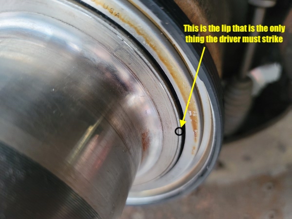

    This is the one used on my 2017 trailers with Hendrickson ULTRAA-K-40K chassis (taper spindles, drum brakes). Stemco tools have interchangeable heads. You buy the striking tool once, then collect the specific heads as needed. Other mfr's probably similar. Utility knife for scale. Having used this on 8 wheel ends, I would put the odds of getting a seal on undamaged without it as highly unlikely. It has to go on perfectly straight and the contact area on the seal is a thin steel edge surrounded by mashable soft pieces. Just looking at the new seals before I started, I knew this was the way.
    These seals were an interesting design that I had never seen before. Stemco Voyager was the brand and model if I recall, and was not what was on them originally. They don't press into the hub. You knock the dust shield off the spindle and the seal drives up on the spindle where that used to be. Then the outer diameter of the seal pushes into the hub bore. Makes mounting the hub a lot less awkward since the inner bearing is already up on the spindle perfectly in position. Must've been an upgrade, as that was what the Great Dane dealer handed me off the vin numbers.
