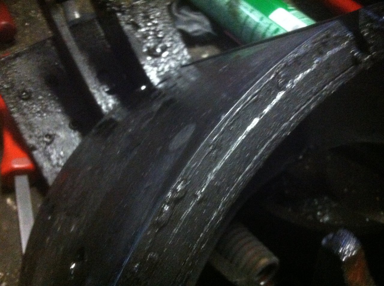

    I've done it both ways .... Cleaned the shoes up and run them and just replaced them....
    Do you replace brake shoes after they've been covered with gear oil from a blown wheel seal...?
    P.S just changed another pair that were pretty thick..,
    And I'm Kinda cranky

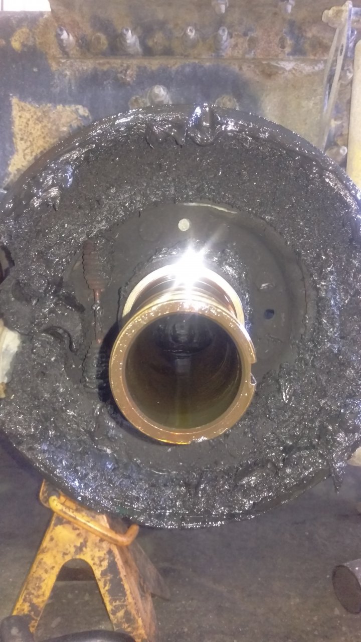

    Seldom do they need to be replaced IMO. In a case like this, definetly replace lol. IMAG0220.jpg

    Yeah if it is super nasty and half the pad is gone then for sure new pads. If the pads are like new then I clean them.

    ab-so-lut-ly!
