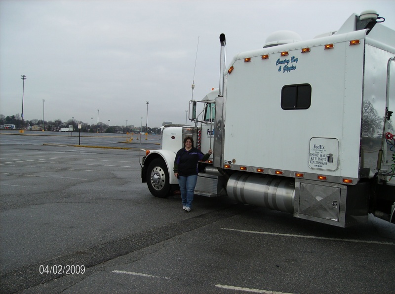

    we drove a 379 pete with a 323" wheelbase for about a year at Fed Ex Custom Critical.....i was a bit worried about how difficult it would be docking etc...once ya get used to it, its no big deal...we both docked in places customers told us guys with reg wheelbase trucks wouldnt even attempt.....
    BeN DaViS and HellStomper116 Thank this.
