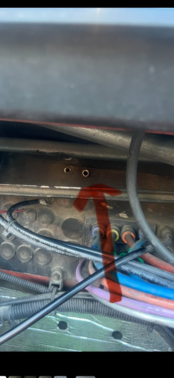

    IMG_2748.jpeg Air leaks from this hole in my firewall, and from the bottom of one of my brake valves under the trailer…. Am I safe to assume that I need to change the brake valves?

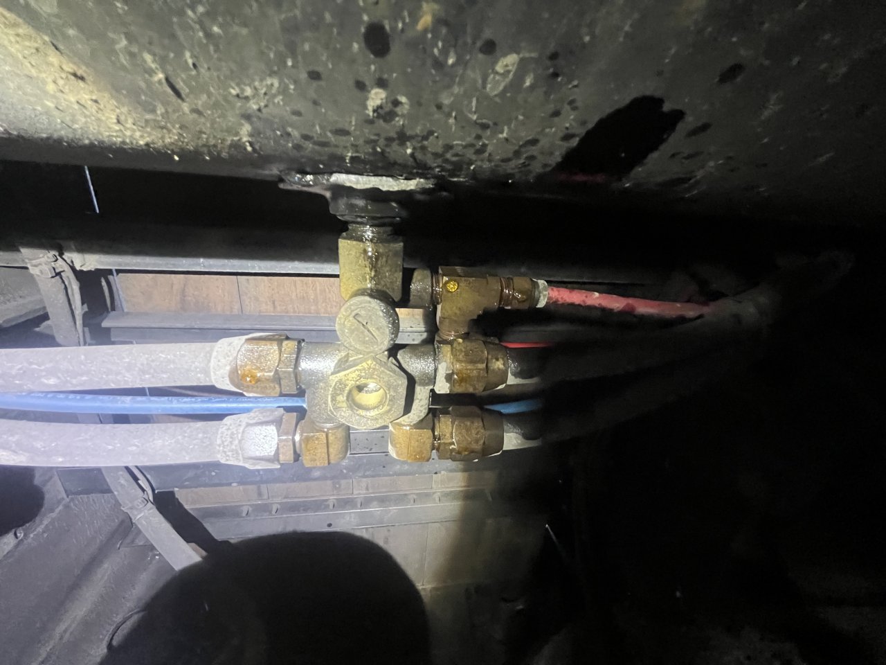

    The wetness on the valve is PB Blaster

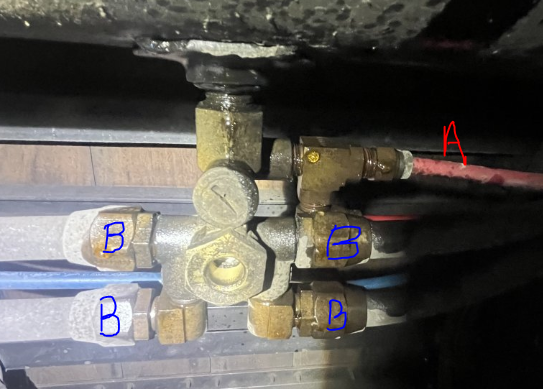

    Are you saying that air leaks then stops or that air continues to leak after the trailer park brake is set?
    Are these the only 5 air lines connected to the valve? Can't tell if either the red or blue line behind the valve are connected to the valve.
    Follow a B line. Probably goes to the spring brake end of a chamber which is not the end closest to the slack adjuster.
    If so, remove line A to make sure that air is not coming out of it.

    That's the quick release valve for the spring brakes. I had 1 doing the same thing back in the spring.

    What did you end up doing?

    The air leaks from the hole in the center of that valve, and from that hole on the firewall for a good...45 seconds maybe. Id have to get up under my trailer and see if that blue line is actually connected to that valve.
    While its leaking(after I set brakes) if I run under there and plug that hole with my finger, I can hear all the brakes set( scared me the 1st time I done it cause I was laying under there)

    Put a new one on.
