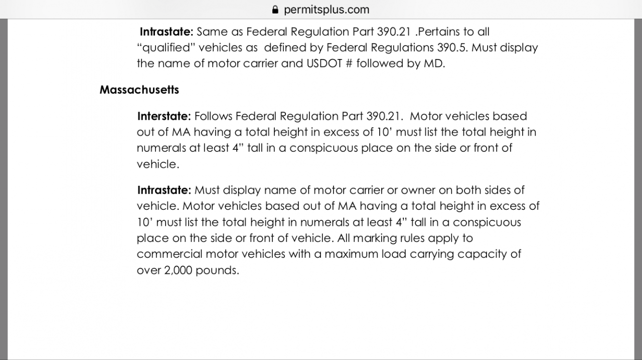

    96E3EF81-3992-44B8-B765-38E6B07F48CA.png 96E3EF81-3992-44B8-B765-38E6B07F48CA.png
    I didn’t find the thread, but did find the info. Google commercial vehicle sign requirements.

    Unless somethings changed recently, Only things required are Co. Name. The letters USDOT ( no spaces or periods immediately followed by dot #, USDOT 1234567 and Truck #, Vin# if running Colorado, and I think NY requires you display HUT sticker.Everything else like city, state , mc# , is optional. Displaying kyu # is optional also. Putting your company name followed by the words” leased to ABCTrucking “is also optional, if allowed by ABC
