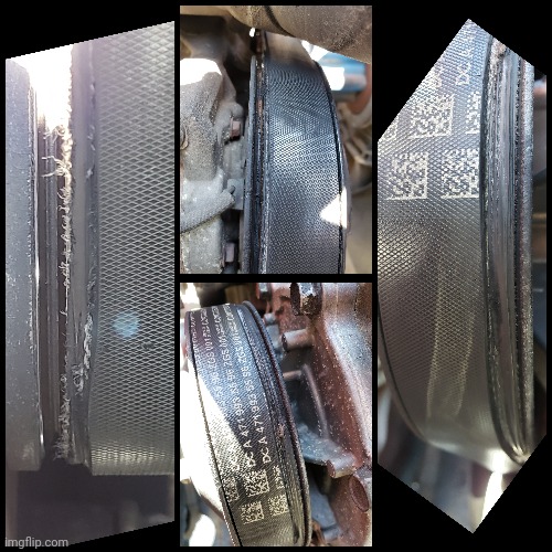

    what does it mean when a belt looks like it's cut in from the top, scooped out in some spots but rib still there, other spots edge rib clean sliced off. new front cover had the shop take off and put back on tensioner and vibration damper, the only place you can't see where something could be rubbing is under vibration damper tucked into motor mount

    That used to happen to mine when it was out of alignment and jumped the pulley. Usually but not always jumping off.Ive even used a 6 rib belt instead of an 8 rib, centered, to catch it when it jumps a rib on the pulley. I replaced my front covers and damper recently. So far at 50k miles. No more problems. If everything’s lined up right, you shouldn’t be having that problem. You’d think they replaced the belt. Aside from a tensioner going bad, can’t imagine what caused it. I would buy 2 belts. An 8 rib, and a 6 rib. Run the 6 rib centered, see if it jumps the grooves. If not, throw the 8 rib on and keep the 6 rib as a spare. Good for a spare, especially if belt failure is from a misalignment. Get you to the Dealer for the right parts, A new tensioner, keeping the old one as a spare, isn’t a bad idea either. That’s what I’ve always done anyway. Along with any short belts needed to run alternator in a jam, should another accessory like a/c lock up.
