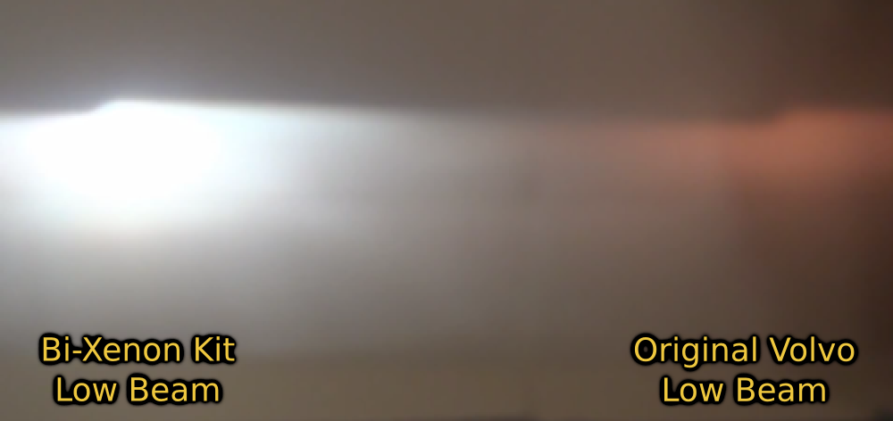

  8. KB3MMX
    KB3MMX Road Train Member
    3,075
    2,595
    Dec 29, 2014
    Orrstown, PA
    Great comparison to the horrible halogen lights
    dustinbrock Thanks this.
