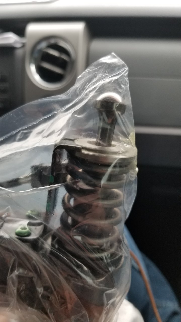

    @ShooterK2 or @OLDSKOOLERnWV what does the manual mean by bottom out the injector timing plunger? Is it talking about the part the rocker rides on or the part that is inside the spring?
    I'm guessing the ball end piece is the plunger its referring to. 15722927218413326518621925223937.jpg

    Install injector tighten adjustment on injector rocker to bottom out plunger then set to spec

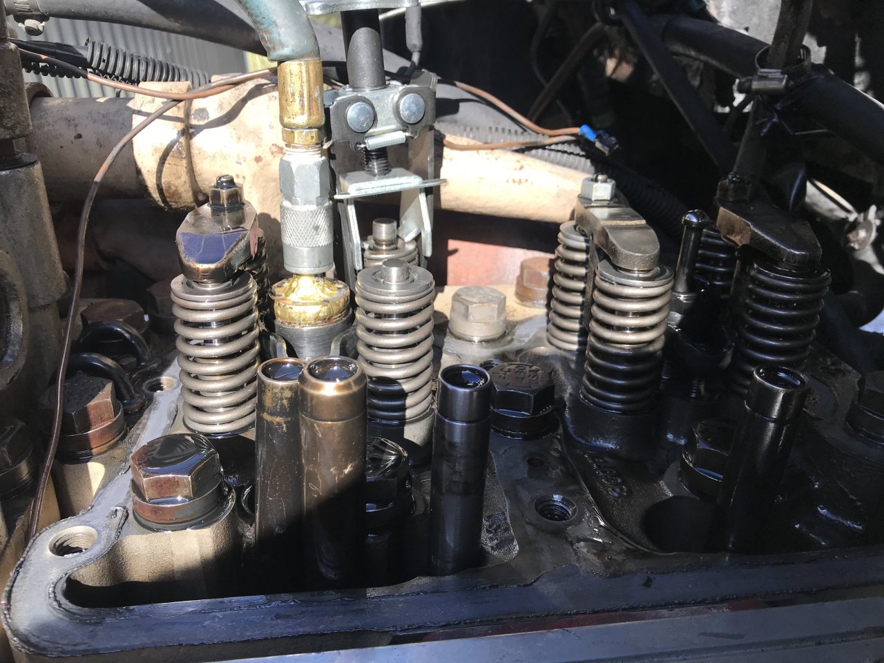

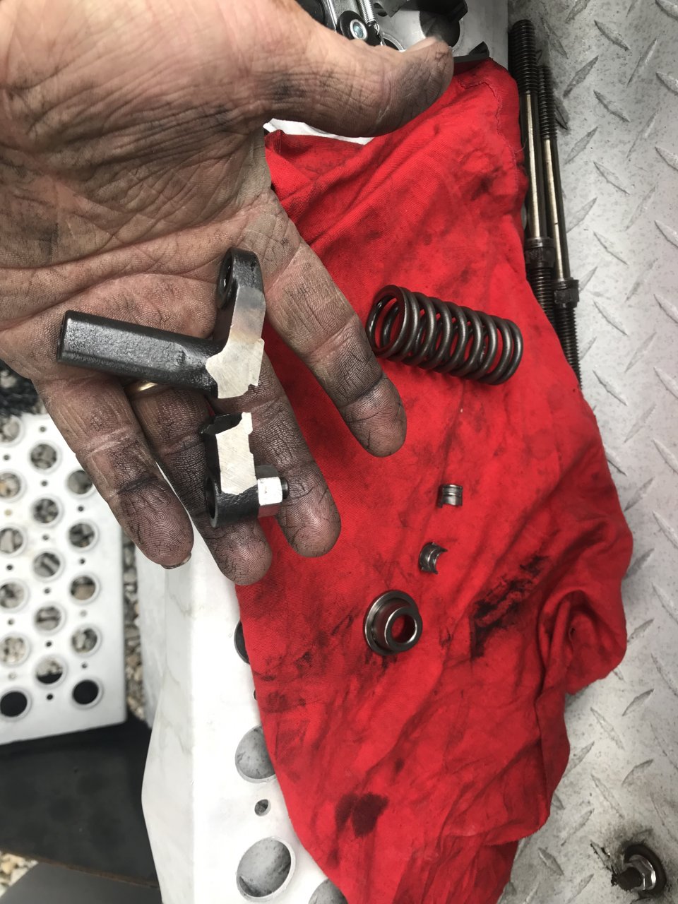

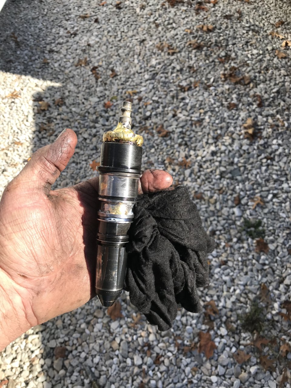

  9. OLDSKOOLERnWV
    19,317
    291,994

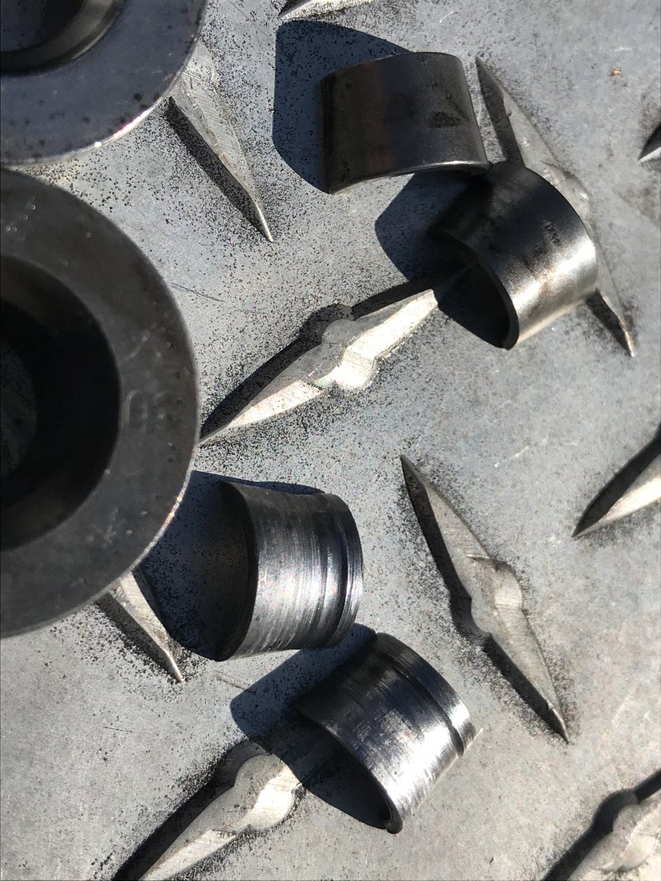

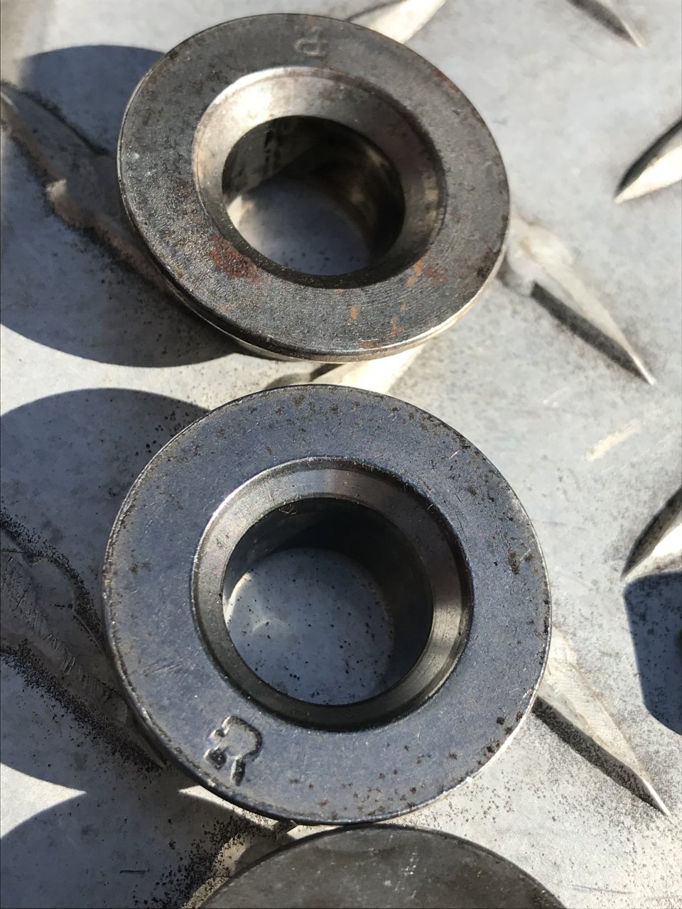

    CD6B8AB3-CE33-4D13-8441-BBAE84679A61.jpeg 9DA7DC6C-253C-4181-AD3B-567D3F3167F4.jpeg 6250EE70-4938-4743-9A6A-A8EBBC551B1F.jpeg EA4E4E2B-97B7-4222-B706-642477DB1AE0.jpeg E914E169-24B4-4F38-B5D9-2B817EC0ED6B.jpeg
    Don’t feel like the Lone stranger.....
    Taking care of a small oil leak on my rocker box and happen to see a broke bridge! After looking closer I found the valve springs were a good 1/8” to 3/16 difference in height (intake valves). Starter looking then seen the problem, keepers were countersunk in one set of valves, and perturbed on the other causing a difference in height. Needless to say that much difference caused a big difference in spring pressure!
    Then I had to figure out how to get the valve spring off without pulling the head...!! Fortunately I had a spare injector to alter in order to pressurize the cylinder and hold the valves shut. All in a days work I guess lol. Just glad I have the ability to do these things myself....

    Makes my injector woes seem like child's play. Least you dont have a ton of #### above your engine to get in the way of workin.
