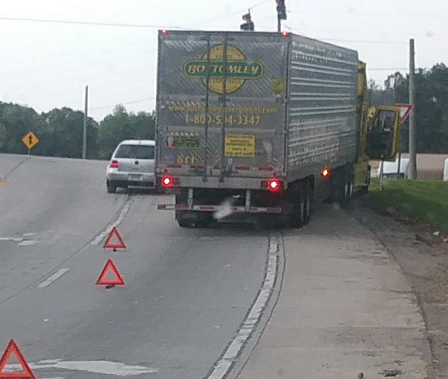

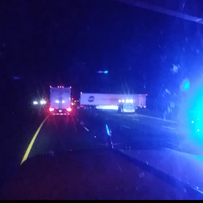

    Notables of the day. Sick cabover hogging the "fast" middle lane.
    Some driver definitely matching the company name locks up a 2016 engine. In 20 mins of sitting he hasnt lifted the hood. I ask if hes got any oil in it. "Good question, i havent checked in quite a while." He cant figure out the hood latches and theres a rotted dead bird behind the headlight. Stick almost dry. Yeah i guess its been a while. Doesnt even have oil on hand so why check?
    Pretty good jack knife north of ATL.
    The best of the night was a car spun out between lane 2 and 3 of 6 or maybe 7 total lanes, in the tunnel underpass on 285 bypass. The Lord placed two trucks right behind her who managed to stop, then vee'd up to make a wall of protection, or this lady woulda been run over. My hats off to you gents, nameless angels, praise the lord.
