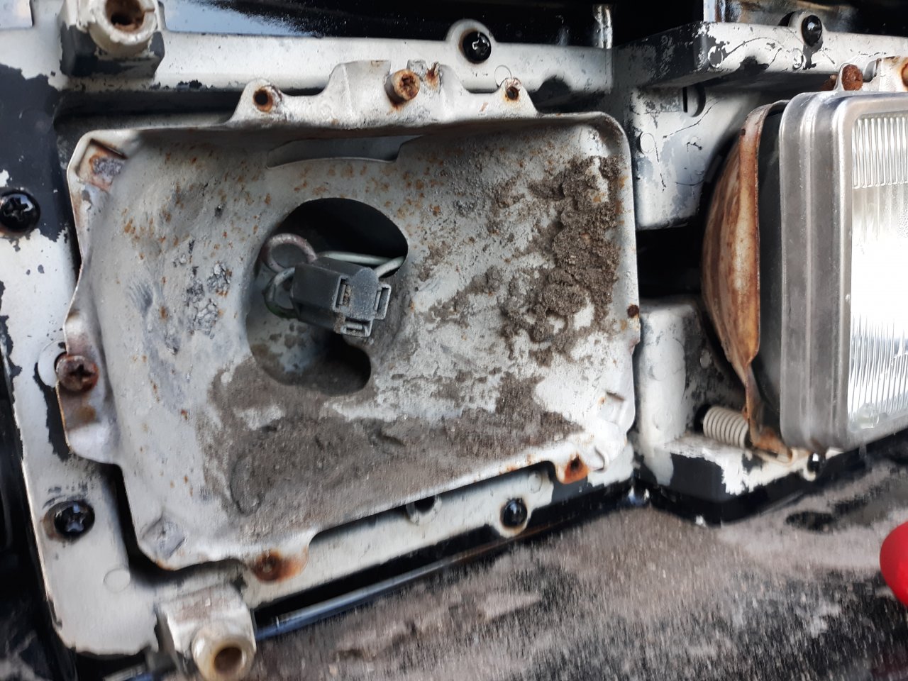

    Gave me headlight bucket out of a junk, yet didn't bother to clean it out. 20201223_170929.jpg

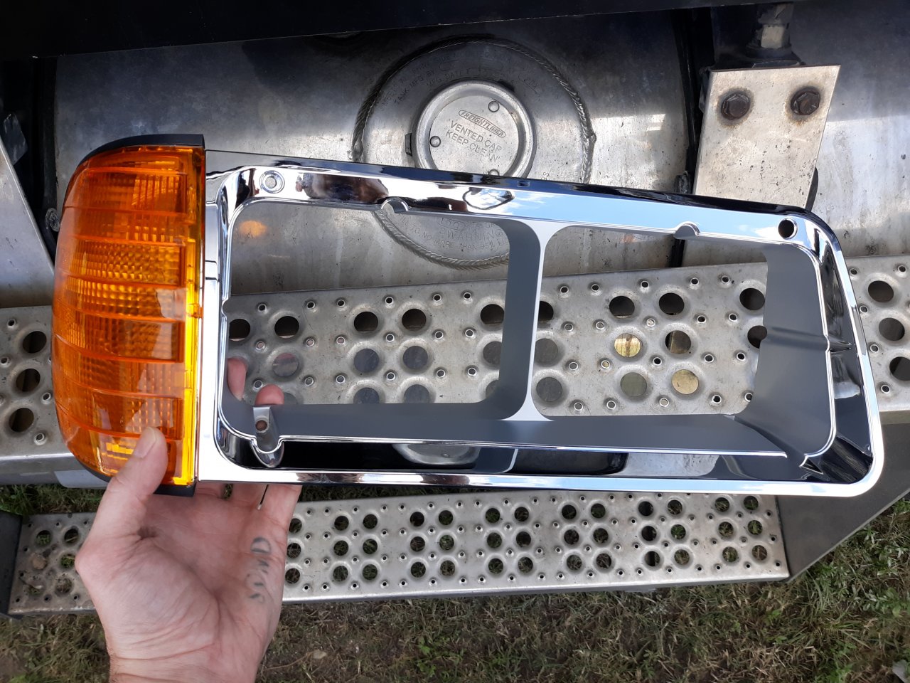

    Tried to give me a bezel of the junk. Did get a this new one out of them. But they jammed them in all c ockeyed to the point only 3 of the 4 fasteners would go in, so refitted them myself..

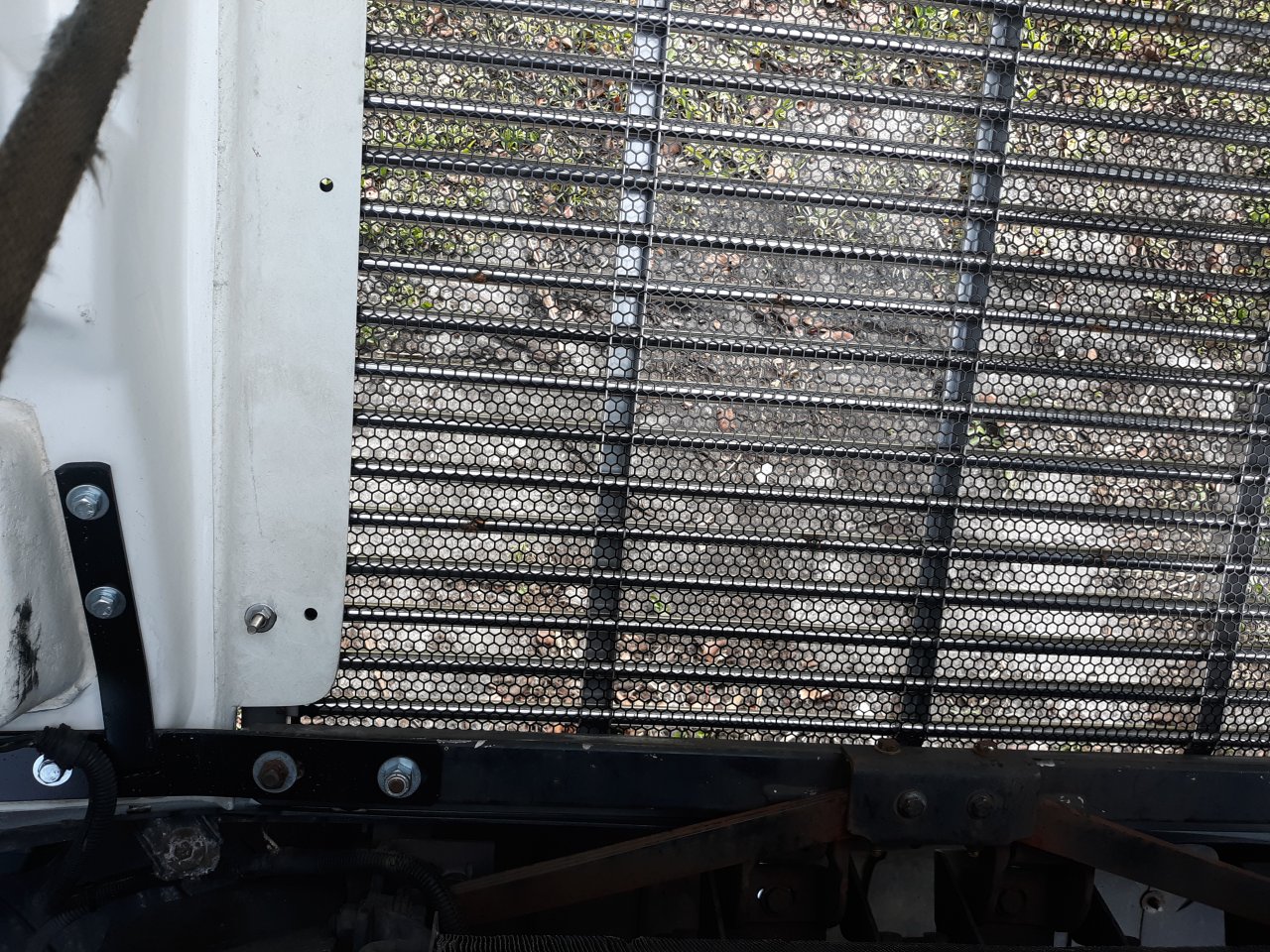

    The gille washers looked too small to me, & they hung it with no rubber isolators between the steel & fiberglass. So while taking that back apart, I snapped 3 of the 4 bolts off. Stainless nuts on stainless bolts apparently muttles.? I just learned this, but the "professionals" whom mounted it should have put antisieze on the treads.. So now the grille is at my local welding shop getting new bolts welded on..
    Also that Hogebuilt is the most expensive stainless steel grill you can find for an FLD or Classic. Well their craftsmanship ain't great either. Most the tack welds on the honeycomb in there popped too, so she was rattling something fierce. All that will be tacked back together too, but sheesh. Come on Hogebuilt... :mad:

    Holy #### @singlescrewshaker I coulda done a better job in the backyard! Aside from paint of course.
    I needed a new bumper on my pickup this spring. Got it back from the body shop and had to spend almost an hour adjusting the whole dang thing because it was so far out of whack. It was crooked left to right, hanging about a half inch low, it was in closer to the body on one side AND it wasn't centered. Should have just had them paint the corner piece and replaced the thing myself. Granted I am OCD about stuff but I think the average person would have complained about it too.
