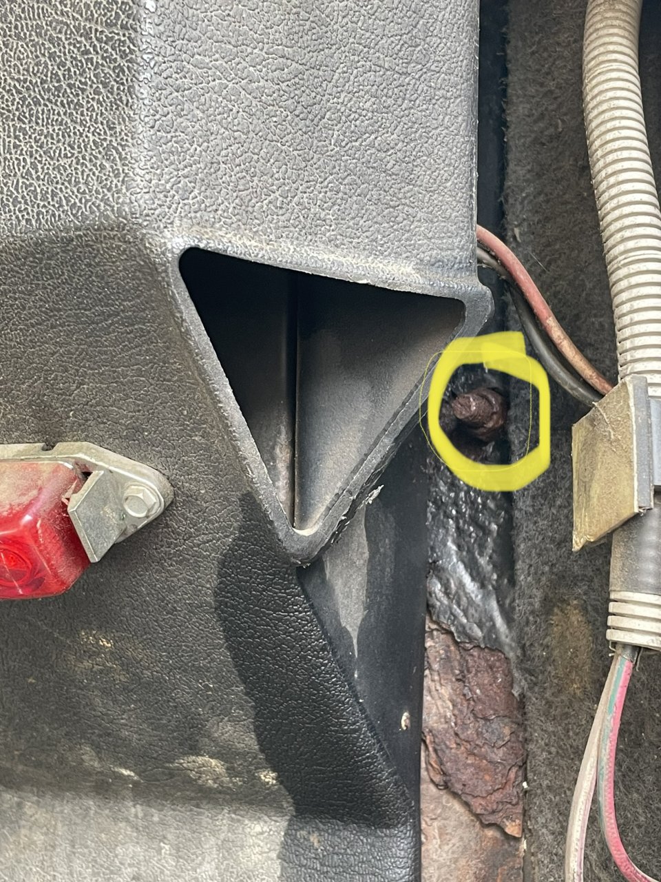

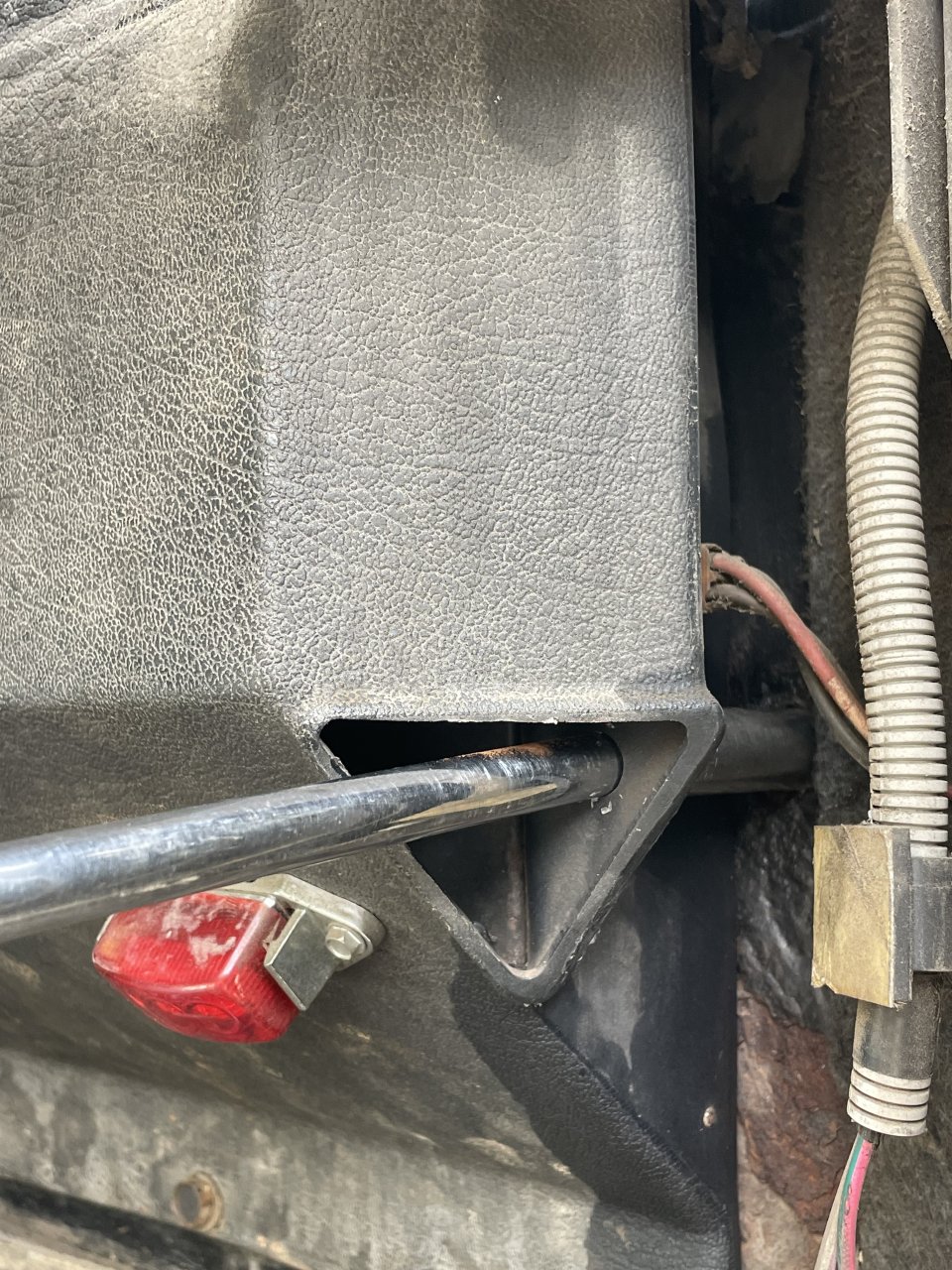

    Working on this a/c unit, ordered a new box and trying to get this 1 nut off inside. Shallow well to shallow because of the amount of stub sticking out, and deep well to long with a universal joint. Decided to drill a 1/2” hole in the back of the vent opening, made it quite easy to remove then….

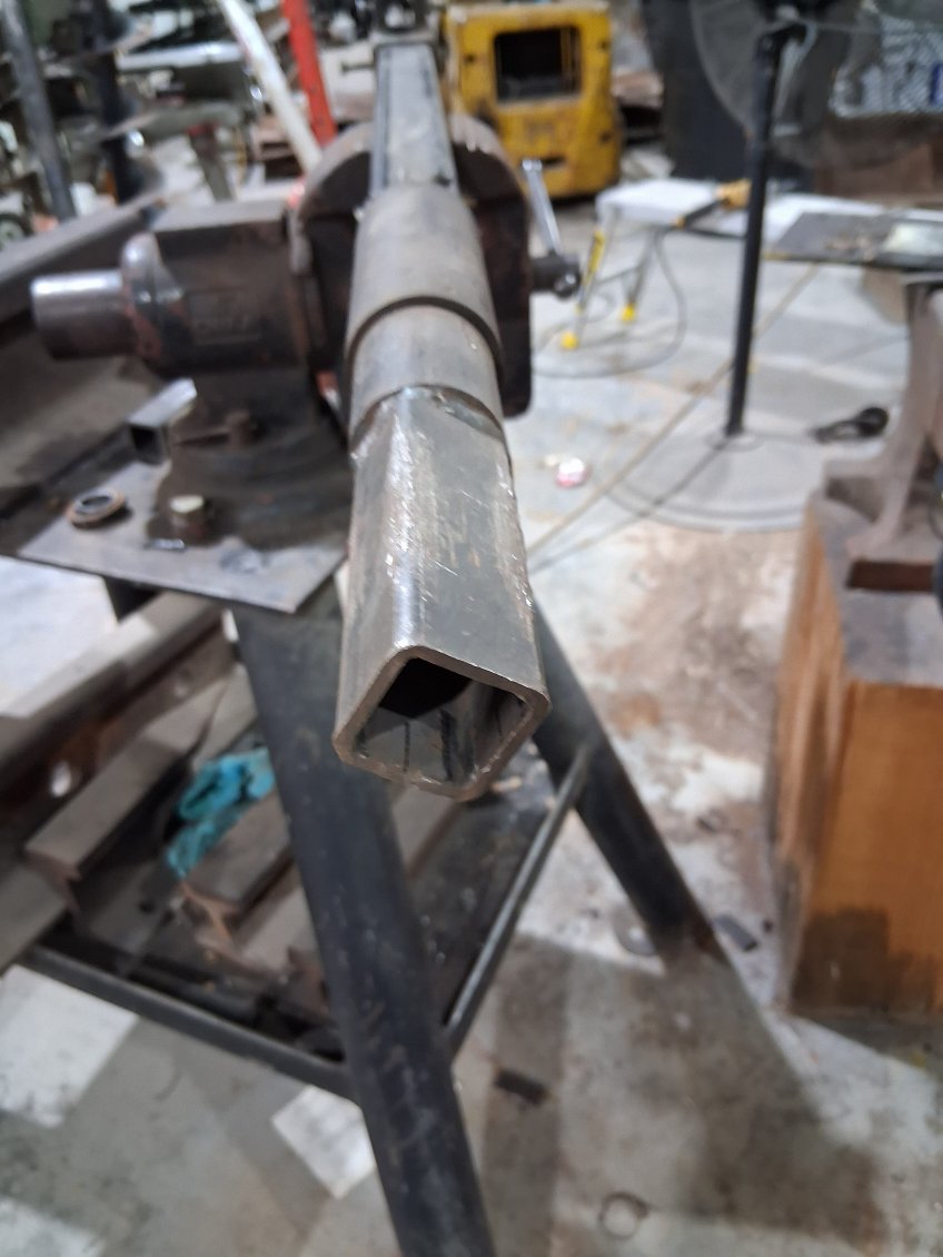

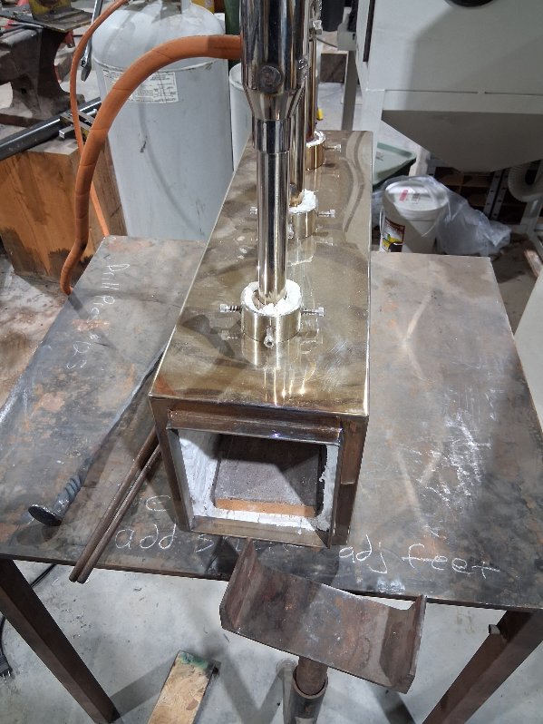

    @AModelCat pictures of the forge, twister, and the 1 piece I could get hold of from the ground. The rest of the pickets are on a pallet on top of the rack, I'll get them down at some point soon.
    Simmonds brand I ordered from amazon. I've only used 2 burners so far. I wanted the depth more than anything.
    That's a RR spike I was messing around with to turn into a steak flipper.

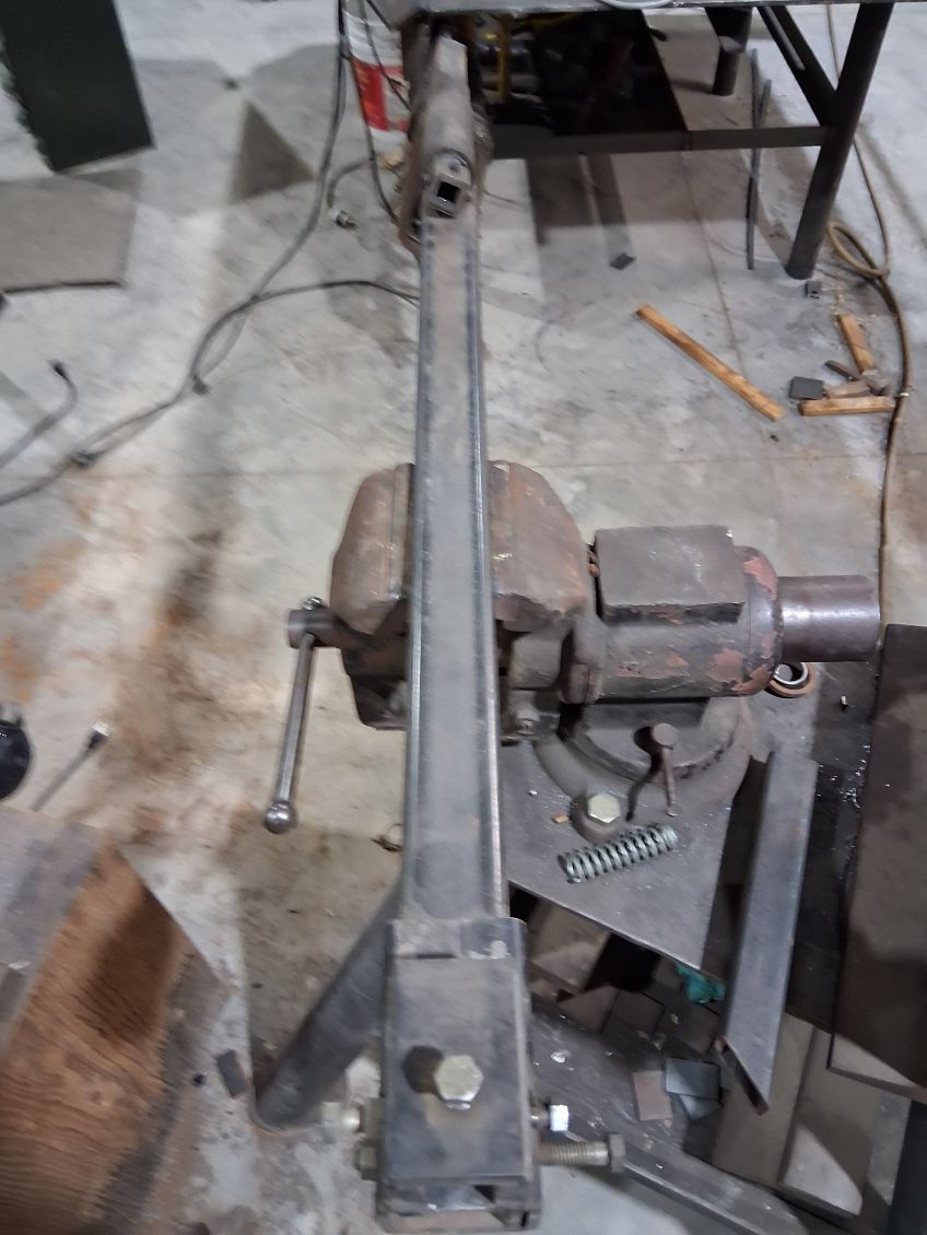

    The picture is kinda fuzzy, but it just clamps in a vise. Other than the set screws, nuts, and bolts, everything came out of the scrap pile and I threw it together in an afternoon. I never dreamed it would work as good as it does.

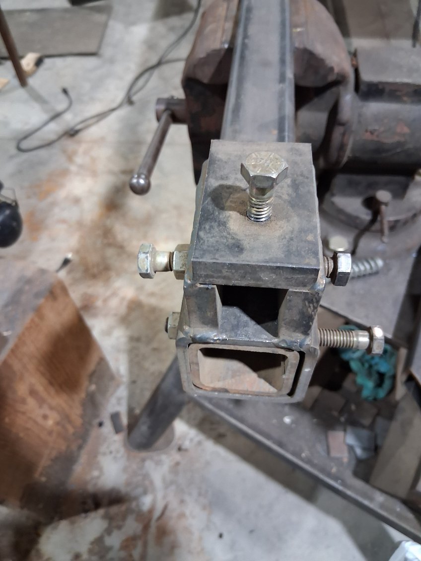

    This is the clamping end. The bottom set of bolt and set screw allow it to slide along the main tube. This allows for different lengths to be clamped. Everything with a jam nut on it is "permanently" set. The other bolts and set screws can be loosened to allow the clamp to move, or the bar stock to be put in and removed, without having to recheck everything. As the bar is twisted, it will dogleg where it transitions from straight to twisted, or where you change the rotation of the twist.

    @AModelCat
    This is the twisting end, it has about 1/2" of forward/backward travel. This allows for a little forgiveness on lengths. There are 4 sets of punch marks spaced around the circumference of the round pipe. These are 1/4 turn marks. I just draw a chalk line on the outer pipe, so I have a reference for counting rotations.
    When I first started using this, I used a 24" pipe wrench to twist 1/2" solid bars and a 36" to twist 5/8" bars. All of them were twisted cold. Later, I got a 1" socket set, and the ratchet fits perfectly in the square hole. It makes 1/2" easier to twist. I have not tried 5/8" yet.
    It is hollow, to allow the bar to be longer than the twister. Then it's a matter of a few measurements to make sure you index it correctly to move along the length.
    This is clamping end of the rotating assembly. When using the punch marks for reference, the set screws at #1 and #2 are the only ones loosened. #3 and #4 don't get touched.
    This was one that I alternated the rotation. I have some that are twisted right for 12", straight for 12" and twisted left for 12". Along with a 12" twist in the middle and straight on both ends. The sky is the limit with this thing.
