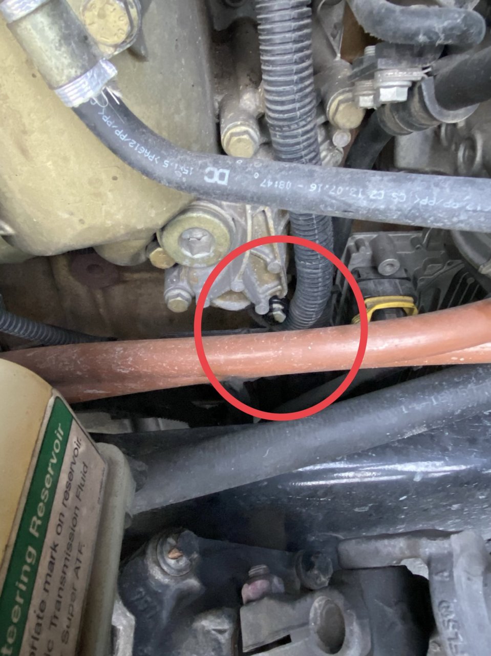

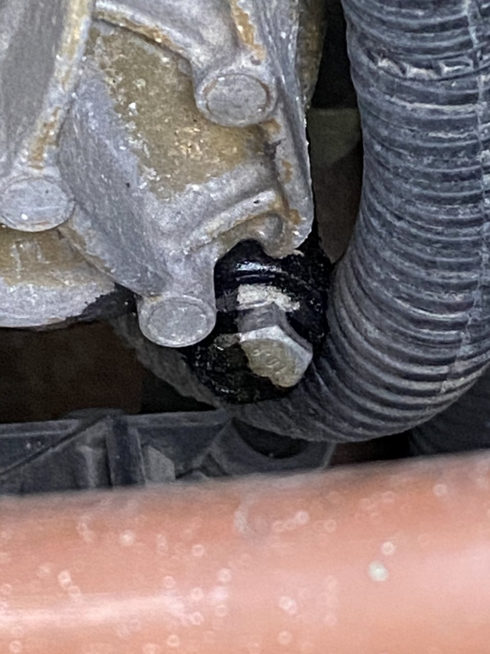

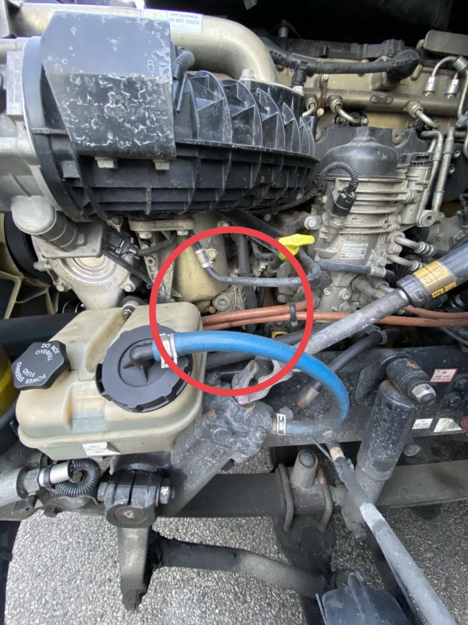

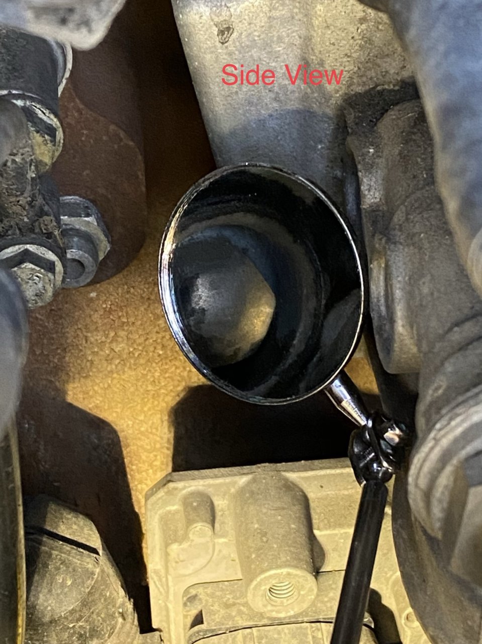

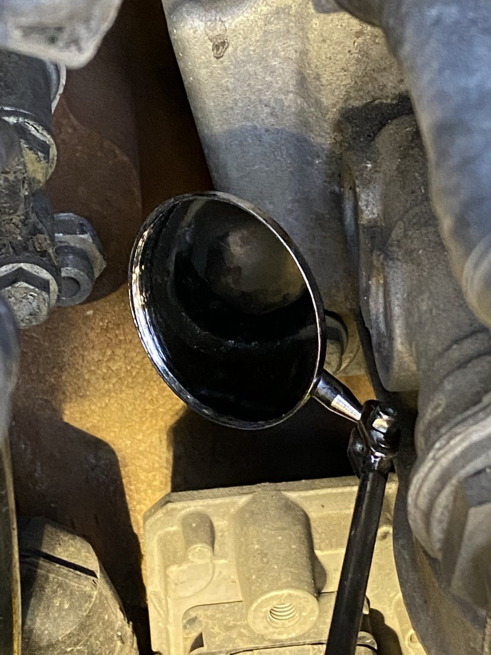

    I just found this minor leak on the oil filter housing. It’s hard to see where exactly it’s leaking from. This is on a 2014 Freightliner Cascadia with a DD15.

    almost looks like some sort of "ball plug", that is used to plug up a hole(s) when the casting is drilled out for passage ways.
    at least, in one of those pics, looks like a ball plug.(the one pic where you used a mirror)

    all dd15s one day will leak there... unscrew that cup and replace the o-ring. p/n DDE A4729970145
    that piece is called oil temperature regulator.
