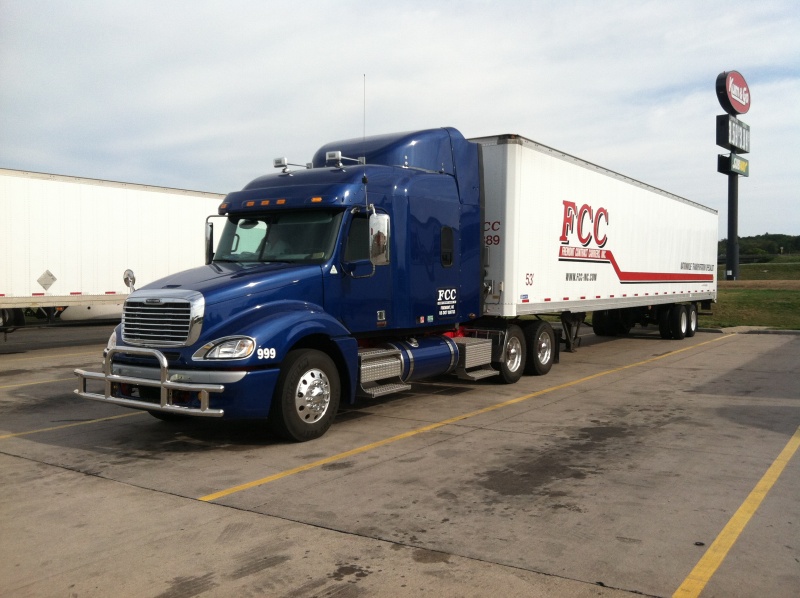

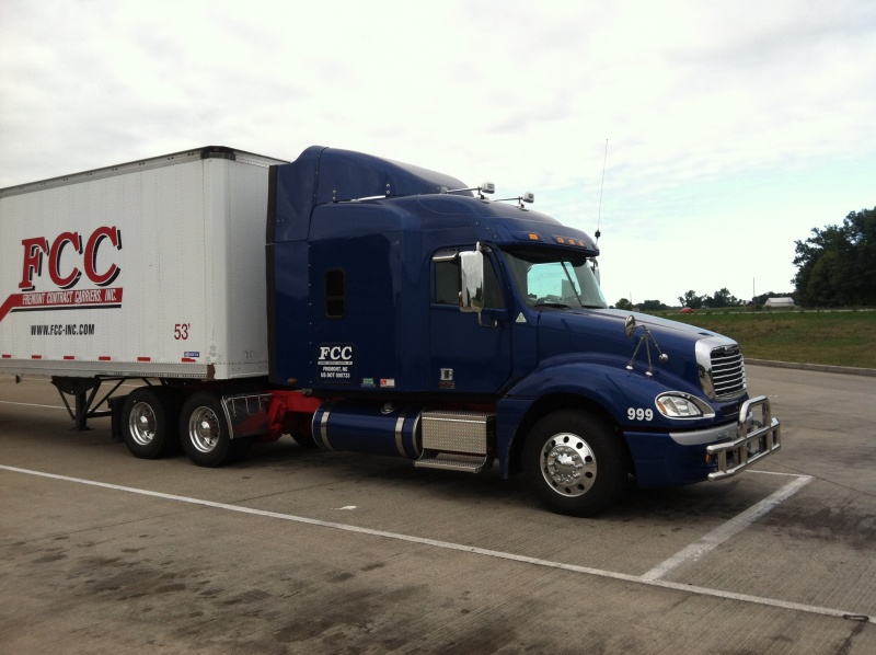

    lol calm down....i just wanted to see the truck! Looks good! what kind of front axle weights do you get with the set back axle and tanks?
  3. Cowpie1
    Cowpie1 Road Train Member
    5,569
    4,651
    Nov 25, 2008
    Kellogg, IA
    I have the 5th only 1 notch from the front (2 inch slide increments) and on a 45K load, I was at about 11,600 on the steers, with full tanks. Steer weight will never be a problem. Nice thing is, with that 45K in the box, I still could easily put on another 2K. I only spec'd 100 gallon tanks on this one. Since I primarily stay in the upper midwest within 600 miles of the house, having 150's on like my last truck was unnecessary. Even 120's were not needed, so I went with the 100's to free up frame rail space and keep the weight down.
