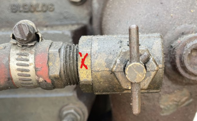

    Only two valves, correct. I think the rear valve is the one giving me issues. I think both valves are the same thread size so I’ll change both. Hose looks to be 5/8”.

    Front valve’s hose runs back to the sleeper. Rear valve’s hose, runs to the heater core. They’re just making the big loop. I’m assuming, the flow is from the rear valve to the heater core, then to the sleeper’s heater core, then back to the thermostat valve, at the front of the engine.
    Rideandrepair Thanks this.
  4. Big Road Skateboard
    6,273
    34,602
    May 2, 2021
    You are correct on the flow. Basically a supply side and a return side.
    Though I've never seen one plumbed like that before. Sometimes a tee to the bunk on supply and return, but not routed through the front, to the back, and out the back to the return.
    Kinda odd
    Rideandrepair and mile marker 27 Thank this.

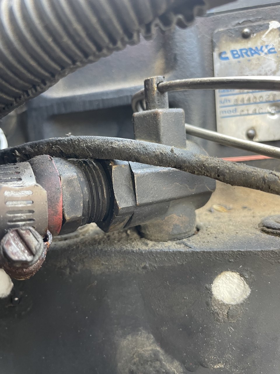

  7. mile marker 27
    mile marker 27 Road Train Member
    1,294
    1,667
    Dec 4, 2019
    Do you guys know, if that’s 5/8” male threads and 5/8” female threads, for the hose barb? IMG_6967.jpeg
  8. Big Road Skateboard
    6,273
    34,602
    May 2, 2021
    Should be 1/2" pipe thread on both

    Got it fixed. Replaced the rear valve and heater hoses. Preciate ya’ll.
