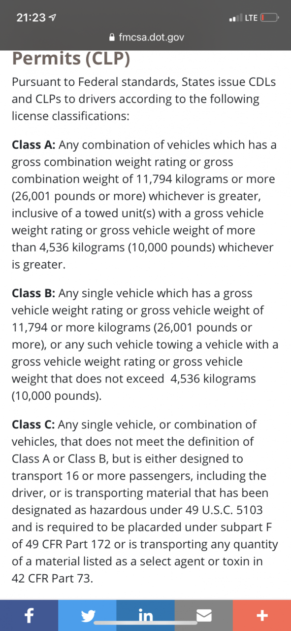

    Not in Missouri
    incorrect, brake type has nothing to do with license class. F2ABD40A-F6A7-46A6-B759-191150B7CE93.png
