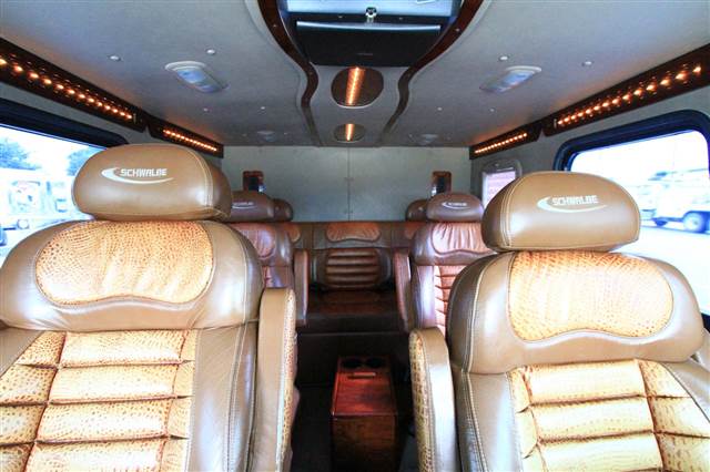

    Just think Schwalbe does a heck of a nice interior job. They used to upfit all makes, maybe they only do Paccar (Kenworth & Peterbilt) cabs now.? But they may still do sound deadening, seats, entertainment, & all that jazz if you bring them a 4 door M2..?
